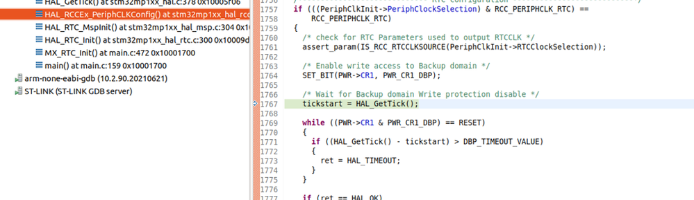

Hello @PatrickF​
I attach the call trace,
Its while getting the tick. Rest of the peripherals works well , if I comment this or run with this in engineering mode.
But as soon as I turn on the Production mode and debug this , I get this.
there is no change in the main code and it is as it is generated by CubeMX
if(IS_ENGINEERING_BOOT_MODE())
PeriphCommonClock_Config();
else
MX_IPCC_Init();
MX_OPENAMP_Init(RPMSG_REMOTE,NULL);
IS_ENGINEERING_BOOT_MODE is 0
Thanks in advance to look into this.
Best Regards,
D
Seems you are trying to init the RTC while it is already init by Linux when in production mode.
The code I have put should be enough to access RTC time/date.
The hardfault is likely coming from instruction before the GetTick, e.g. "SET_BIT(PWR->CR1..." which is not allowed in production mode (PWR is likely secured by Linux)
