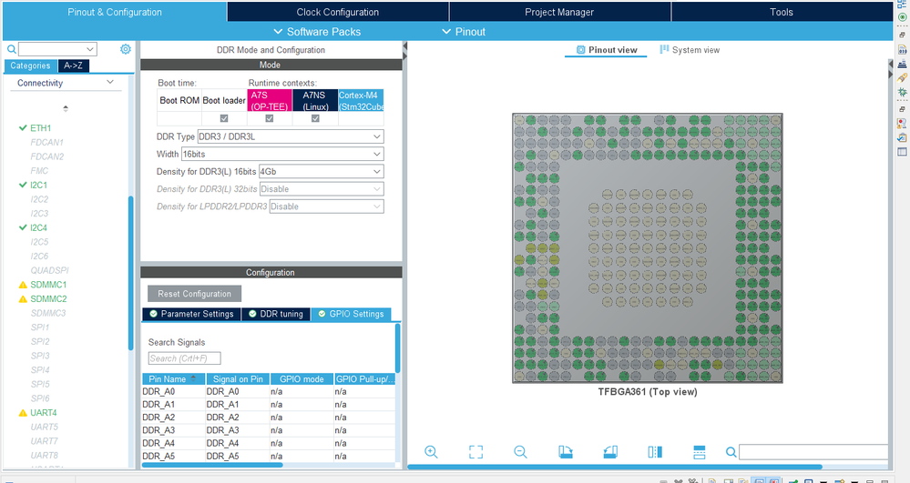

Unable to Configure DDR3 for Cortex-M4 using CubeMX. If DDR3 is dedicated for Cortex-A7 only , how Cortex-M4 is running

Hi Maksh.1 (Community Member)
Indeed, DDR is dedicated to Cortex-A7. Cortex-M4 can run out of SystemRAM or external storage via QSPI/FMC
https://wiki.st.com/stm32mpu/wiki/STM32MP15_peripherals_overview
Thanks @OlivierK​
It means by default Cortex-M4 runs on SystemRAM unless we configure FMC to Cortex-M4
OlivierK
That's correct, the Cortex-M4 runs by default on MCU-RAM (not SystemRAM as previously mentioned) unless FMC or an external memory interface is configured.
