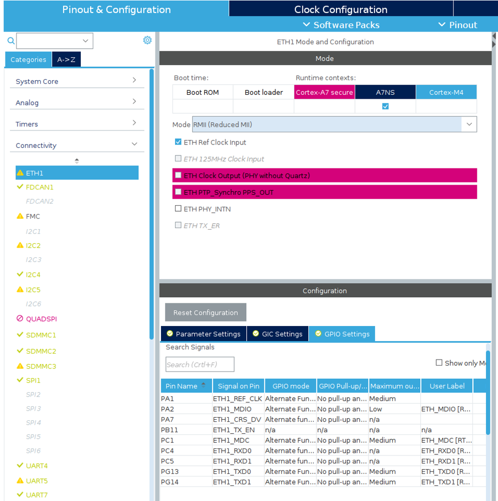

Like the subject, I want change the interface RGMII to RMII using CubeMX.
(RealTek-RTL8211EG-VB-CG => Microchip - LAN8720AI-CP)
Based on STM32MP157C-EV1 Code in CubeMX, I changed the Ethernet option from RGMII to RMII as shown in the picture below.
And after Code Generating, I applied it to my addon(mx) directory and built it.
(Changed to the code generated by CubeMX.)

However, it seems that the ethernet chip is not recognized as shown in the log below.

Thank you for your answer.
​In my case I think it's 3.3.1 from your link.
So I applied the line below to the dts file in my addons/mx/PROJECT/u-boot and kernel directory.

After that, an error occurs when bitbake. Do I need to apply it to a file other than the one in that location?
I'm more HW oriented, so I cannot help much on SW aspects.
Have you carefully followed the steps in https://wiki.st.com/stm32mpu/wiki/How_to_compile_the_device_tree_with_the_Developer_Package ?
This could also help:
https://wiki.st.com/stm32mpu/wiki/How_to_create_your_board_device_tree
https://wiki.st.com/stm32mpu/wiki/How_to_configure_U-Boot_for_your_board
Regards
Tip of the day: Try Sidekick STM32 AI agent, see here
HI !
I solved that problem.
It was a HW problem, not a BSP problem.
But your answer helped me find my HW problem.
Thank you very much!
