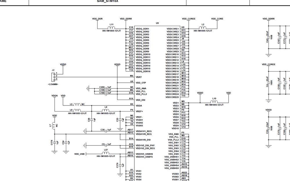

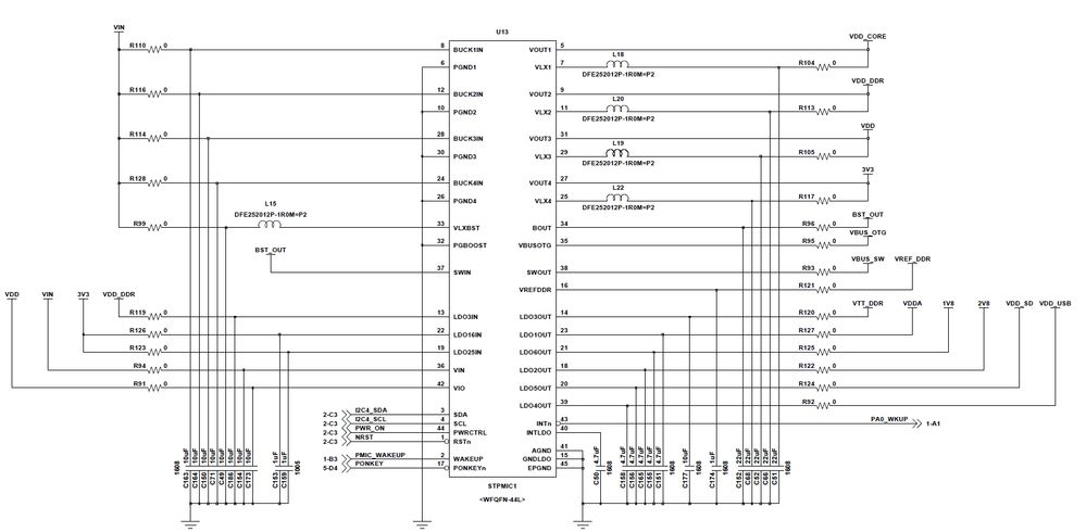

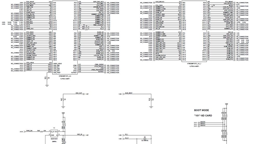

My STM32MP157CAA3 Board Not Boot By SDCARD
I already check SDCARD Clock Pin .. ...
reset MCU and i check SDCARD Clock Pin ... but not signal ....);
I already check Boot MODE -> SDCARD
HELP ME...

If following are verified in the HW (assuming you did not change the OTP content):
  • Boot[2:0] pins are set to SD-Card (0b010)
  • VDD (and VDD_*** pins) and VDDCORE supplies are in the available range
  • NRST and NRST_CORE are high
Whatever the SD-Card content or presence, a clock (about 16MHz) should appear on PC12 pin few ms after NRST rising and could stop after few tens of ms (first level boot).
Then the boot success (second level boot and so on) depend on SD-Card content.
