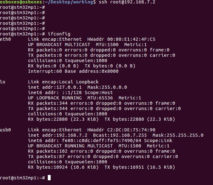

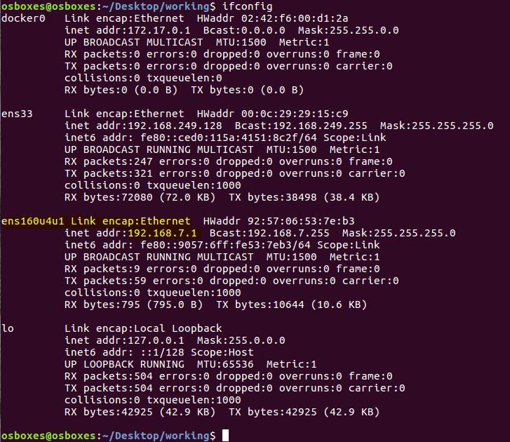

​Hello Anton,
Make sure the DK2 board boot pins are set so that you could see a demo on target display screen.
With the Ethernet/USB bridge (using USB type C cable), you should have the following network setup (or similar) from the host side and board side. I've highlighted the bridge which appears when you plug the USB Type C cable.  I run linux on a Linux VM on Windows 10.

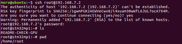

i finally managed to establish a ssh connection between my pc and the dk2 board trough USB-C connection.
I setup 192.168.7.1 static ip for my usb network connection on the PC side.
Then i was able to ping 192.168.7.2 board, also ssh worked via putty.
