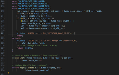

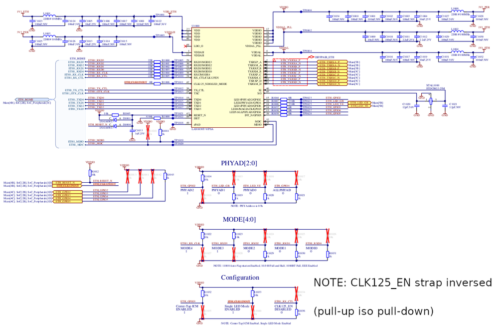

We have the idea that it is clock-tree related (See attached) .
The design is strapped so the PHY generates the clock-source (125MHz for 1GBit)
Some matching issues that we searched on the forum:
Relevant part of our schematics:Schematics.png
Our OPtee/tf-a rcc config see attached dts files (actually dtsi files, but not allowed).

Clocks measured:
Xtal connected to PHY = 25Mhz,
Clock output from PHCLK125= 125Mhz,
RX Clock frequency = 25Mhz,
TX Clock frequency = 2,5Mhz. [Why different compared to RX?]

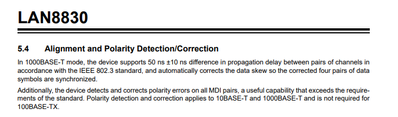

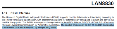

We have some design length differences in signals from Ethernet controller to PHY, which are a in pico second range and should be within limit of the PHY:
Signal length of lines & calculated delays
NameSignal Length (mm)Delay (ps)
ETH1_GTX_CLK_PP1133910
ETH1_MDC_PP1144990
ETH1_MDIO_PP11531052
ETH1_RXD0-NetR1003_2_PP1137935
ETH1_RXD1-NetR1002_2_PP1143974
ETH1_RXD2-NetR1001_2_PP1121799
ETH1_RXD3-NetR1000_2_PP11621110
ETH1_RX_CLK-NetR1004_2_PP11601098
ETH1_RX_CTL-NetR1005_2_PP1126833
ETH1_TXD0_PP11881294
ETH1_TXD1_PP11551038
ETH1_TXD2_PP11811239
ETH1_TXD3_PP12051400
ETH1_TX_CTL_PP1121808
ETH_CLK125OUT-NetR1006_2_PP11551058
ETH_GPIO2-NetR1044_1_PP12031407
ETH_GPIO3-NetR1037_1_PP11691163
ETH_GPIO4-NetR1038_1_PP11601101
ETH_GPIO5-NetR1039_1_PP1131867
ETH_RESET_N-NetC1033_2_PP1144982

stefboerrigter
Update after some investigation
1. We have modified our board (reverted basically) to NOT use the 125MHz from the Phy. We have enabled in TF-A & OP-Tee the
CLK_ETH_PLL4P
which is configured for 125Mhz via the HSE (24MHz) divmn = <3, 124>; st,pll_div_pqr=<5 7 7>;
2. In Kernel DTS we enable the st,eth-clk-sel so taht in dwmac-stm32.c during 'stm32mp1_set_mode'  in RGMII mode the enable_eth_ck is activated. We have briefly checked with 25Mhz clock but that doesn't seem to work (get DMA issues reported in dmesg again).
(Relevant) Dmesg output:

maybe a basic info:
For RGMII, did you enabled the ~2ns delay on RX and TX inside the PHY (sometimes it is thru HW config, sometimes thru MDIO SW control with device tree) ?
Regards.
Tip of the day: Try Sidekick STM32 AI agent, see here
stefboerrigter
Thanks @PatrickF .
We have not set any delay specifically. we just copied the implemenation from the DK boards.
Also not sure if the path differences is wrong, according to the datasheet it is below <1ns differenence, therefore not a problem? but we can test if you give me some more info.
What we do notice, and are not sure about is the difference in TX and RX clock. We see in Linux that the RX and TX clock have different sources (and frequencies), and also when we measure them they are significantly different.
The RX clock is a nice 125MHz clock, but TX seems to be jittering all over the place (or we cannot measure it correctly).
delay on RGMII is a must, it could be either on GMAC or PHY side, but as STM32MP1 does not have embedded delay on neither RX or TX direction, it must be enabled on the PHY side for RX and TX (depend on the PHY driver I guess).
Regards.
