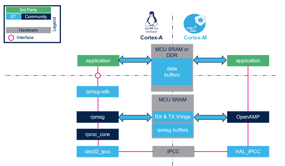

I can share data using RPMsg/OpenAMP. Now I'm trying to see if there is another way to share data, such as accessing memory instead of sending the information.

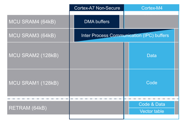

My idea is to write to the M4 core and then read it to the A7 core. I see that the SRAM space is shared between the processor:
0693W00000WJVTAQA5.pngCan I use this part of the memory to share data?

PatrickF
what you want to do seems to fit into:
https://wiki.st.com/stm32mpu/wiki/Exchanging_buffers_with_the_coprocessor#Indirect_buffer_exchange_mode

TArre.1
Hi @PatrickF​
Do you know how to read memory on Linux side? I can write in the memory on M4 side but I can´t read it on A7.
Thanks!
I'm not SW expert, but I guess a Linux application does have access only to its owned memory assigned somewhere by the kernel. You can't access absolute address (Kernel setting of MMU will likely block that)
To read absolute address you probably need to build a driver.
For debugging, you could use sysfs applications like devmem2, but not guaranteed to work on SRAMs.
This is why I think best is to use existing mechanisms like RPMsg. This will be more portable for future Linux evolution.
