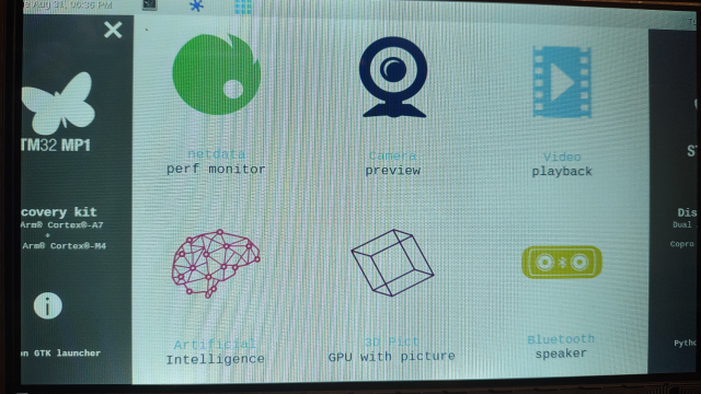

I'm not sure. My display is 800x480 and is running correctly. Did you modify the dw-mipi-dsi.c routine I mentioned above to endure the horizontal active area is passed to the timing routine, not the horizontal total. I will try to a 1280 by 720 hdmi capable monitor and see what happens...
Regards,
Dear @MKonz.1​
We've found an old RaspberryPi display with 1024x600 @ 30Hz and it worked ok with just the modification you've suggested.
Event if it showed a consistent image, a good portion of the image was out of the display: the video output stream was still 1280x720 (like if it ignored the current display resolution and put out an "hardcoded" one).
Maybe this is because last time we skipped the mod to the dw-mipi-dsi.c routine. Unfortunately we didn't really know what to modify specifically to specify an Horizontal Active Area, instead of the Horizontal Total... nor what is the Horizontal Active Area of our display.
I assume Horizontal Active Area is the actual display pixel resolution (1024 in the case of the old RaspberryPi display), while the Horizontal Total is the pixel resolution of the ldc embedded controller (that is usually larger as generic controllers may be matched with generic display... in the case of the old RaspberryPi display this may be 1280). Am I right?
Why the bigger 1280x720 isn't working is still unresolved from our side: if you can do the tests a monitor of yours it would be great!
Thank you again
MKonz.1

Meanwhile we managed to get a DK1 evaluation board (LTDC parallel interface routed to a Lattice Sil9022A), and in this case the HDMI port can handle our monitor at 1280x720 @ 60Hz. In fact it can even do more, adapting it's output size to the available monitor by reading the EDID at first plug-in event: so it can also drive the other 1024x600 @ 30Hz display. Unfortunately it won't adapt if a different monitor is plugged in after boot with another one of different resolution, but it is still something.
We think that this is an indicator of two main issues: the first one, that you already pointed out, is that EV1 "ignore" display size as it was born with the idea to be used with only one DSI display (dw-mipi-dsi.c routine mod to hardcode horizontal active area); the other is maybe the inability of the 2 lanes DSI to support that pixel clock, but we need to further investigate.

Thank you @PatrickF​ for the immediate reply,
I tried your solution (both kernel patch and device tree) but unfortunately doesn't solve our issue which seems to be linked to a wrong computation of horizontal back porch or to a misled communication of EDID informations.
I add an image of my display hoping it could help to figure out the issue; if you have any other ideas or suggestions, they could be of help
Best regards
Marco.
I'm not expert on this area, just linked other post which was on same topics. Maybe @PZak.1​ could have more clues.
Is it the display which is not aligned/sized or the weston screen size which is not correct ?
Maybe https://wiki.st.com/stm32mpu/wiki/Wayland_Weston_overview#Configuration could help
