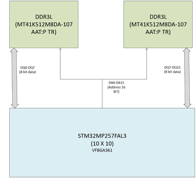

Thank you for your response,
can I use 2 , 8bit DDR3L with STM32MP257FAL3 (as this is not mentioned in the pdf you provided), to achieve 1GByte Memory density.
Best Regards
Abhineet Ranjan
Block Diagram for reference....
