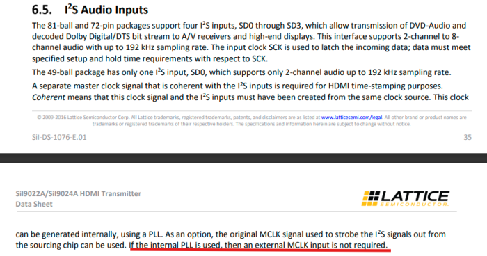

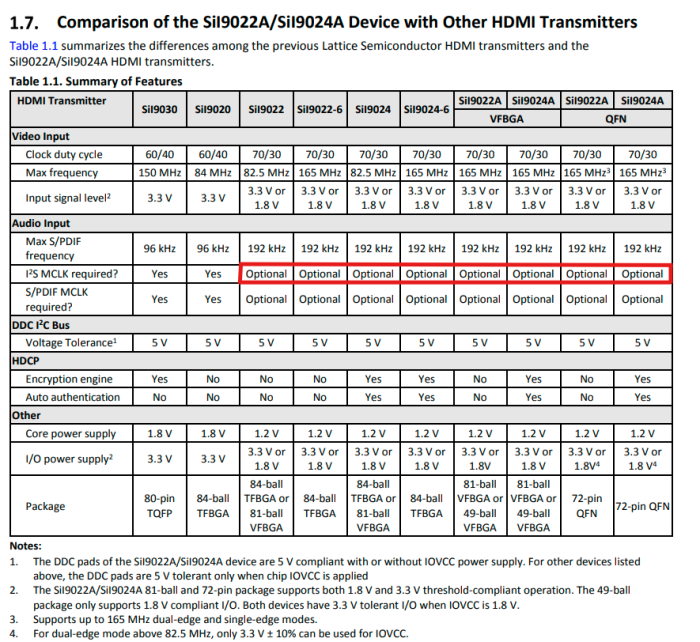

Hi @PatrickF
Note! What you are refering to is not the HDMI PHY.
You refering to another IC chip.
The linux kernel does not support sii9022A without MCLK.
I get these debug messages from sii902x.c https://github.com/torvalds/linux/blob/master/drivers/gpu/drm/bridge/sii902x.c because my device requries MCLK. I have not routed that track from my MCU to the PHY. So sound won't work for the moment until sii902x.c supports PLL as a clock instead of only MCLK.

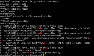

The device tree requries the mclk.
