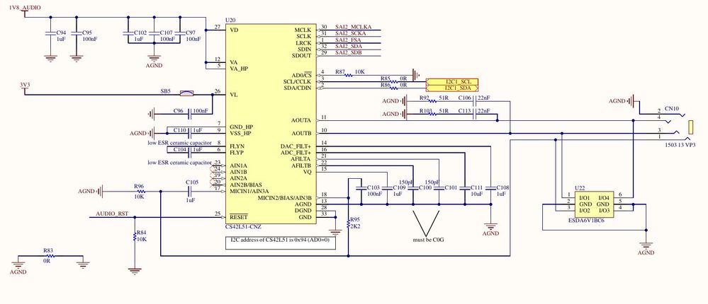

I'm buildning my own computer by using STM32MP151AAC3.
I'm going to draw lines for the HDMI connector. I have one question: Can I transfer sound via the HDMI cable? For example if I run OpenSTLinux onto the STM32MP151AAC3 processor, and then I connect the HDMI cable and I can see the screen. Will I be able to hear sound too if I surf into Youtube?
STM32MP151AAC3 custom board with STM32-OS as operating system: https://github.com/DanielMartensson/STM32-Computer
STM32MP257FAK3 custom board with STM64-OS as operating system: https://github.com/DanielMartensson/STM64-Computer
DMårt
Lead
@PatrickF
Hi!
I solved the problem. Now I can hear sound from my SII9022A PHY.
I did not use ASoC Graph Card, instead I used Simple Card inside Linux kernel.
I post the Linux Device Tree in case if some one in the future want to play some music through the SII9022A.

Because in the Dev-board of STM32MP1 series. They contains a special old-school (imo) audio jack and a chip that are connected to i2s. Is this the "sound card" the wiki refering to? It's from STM32MP15-DISCO board.
My situation:
In my situation, I want to use the I2S bus which linux is recognizing, together with SII9022A HDMI PHY.
This question is more like a software-recommendation question, rather than a programming/configuration question.
I have installed alsa-utils and wrote
aplay -l
. This gave me the information that there are no sound cards found. But I'm not looking for a sound card. Only a way to transfer sound to SII9022A, which is my "sound card", if we are going to use the same terms as linux is using.
If ST have no support nor answer for enable music through i2s to SII9022A, please let me know. Then I will look somewhere else.
