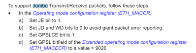

I performed the following configuration:
I have also configured the YT8521-SH ethernet PHY to work with jumbo frames
I have also adapted the size of the buffers respectively.

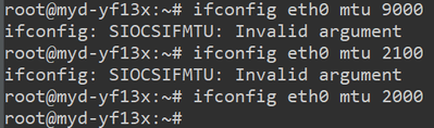

At the end I worked with the OpenSTLinux with both STM32MP13-Devkit and MYD-YF13X. I wanted to resize the MTU of eth interface. With the ifconfig tool I wasn't able to set the MTU to 9000 bytes. Once again, it was constrained to 2000 bytes.
Why is the constraint set to ~2000?

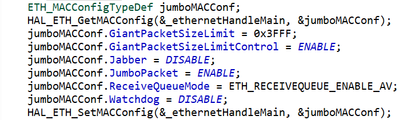

Of course, I can share a sample piece of code.
You might also need to consider the assumptions of my first post.
