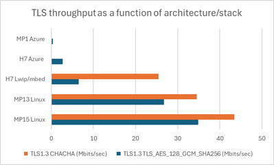

Hello @STea,
The method used to measure this is the following :
- Create HTTPS client and force the cipher suite used to established a secure connection
- Create a local HTTPS server on my computer which host rest API. The GET reply sends 31MB data to the client.
- Request this GET from the Azure client
- Measure the time between the request and the full reply reception
My ethernet configuration is globally  the same between all my test : Maximum Segment Size, TCP Window, buffer size ...
Here are my surprising result, especially results concerning the MP1 and H7 under Azure stack.
I think I'm missing something on the MP1 side, but I don't know what.
Thanks for your reply,
Regards
Hello @Clement7 ,
There seems to be some sort of a bottleneck from MP1 on azure side which I can't see why it is happening. the degradation between azure and non-azure benchmarks is for sure the lack of hardware acceleration and leveraging of symmetric crypto. but the result found should be in the same range as the H7 series for example. I recommend you check the configuration of ethernet and azure the clocks the io speeds and try to run booth test on similar software environments to see why this is happening.
