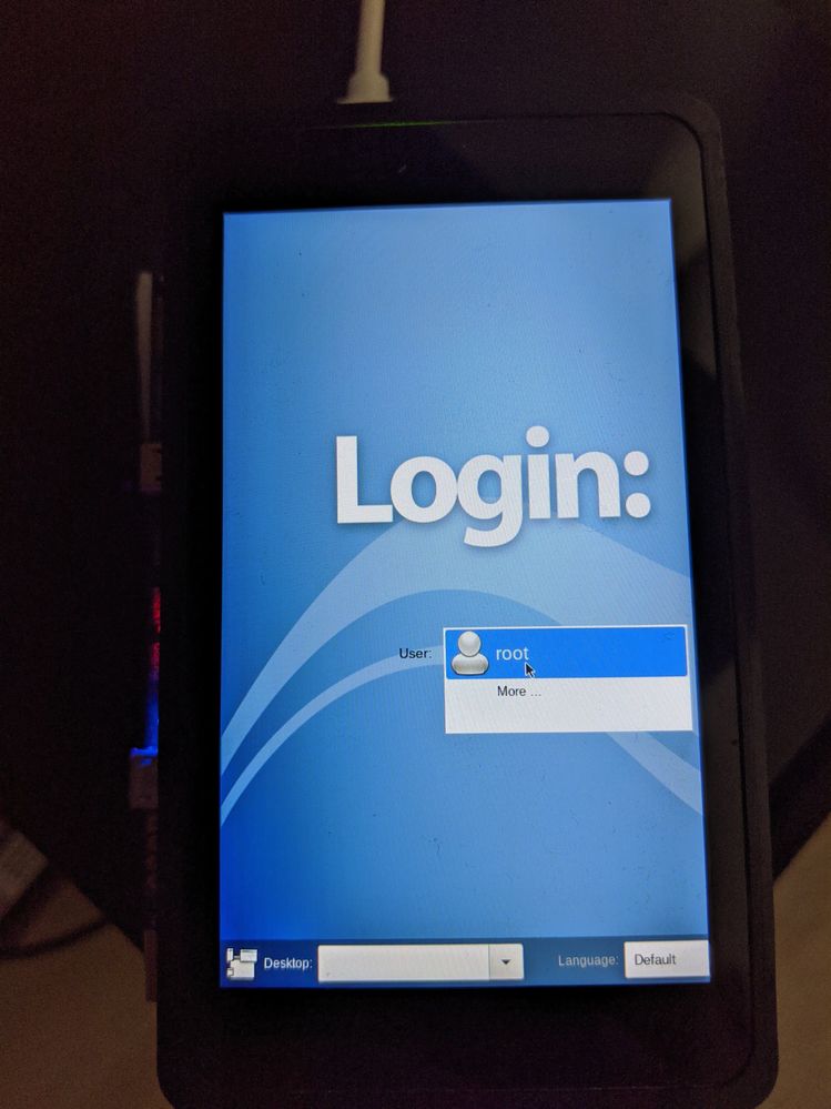

Hi, I also build st-example-image-x11 and flashed it on stm32mp157 DK2. But when device boots, it shows login screen with "root" user and i can't log in and move to desktop. Did you have same problem ? How you logged in ? Did you change something in local.conf file or bblayers.conf ?
Here is the screen:0693W000000UR1zQAG.jpg

Hi, You must configure start-up files in / etc / lxdm:
https://wiki.archlinux.org/index.php/LXDM

When you deploy your image on board, you was able to log in, or do something ?
Maybe i compiled it wrong. When i click on root user, black screen appear for few seconds and then system again return to login page.
Adrian1
Lxdm after click to root, runs PreLogin and PostLogin files, when it is empty it back to logging page. You moust to configure them like in instructions on:
Regards,
Adrian
