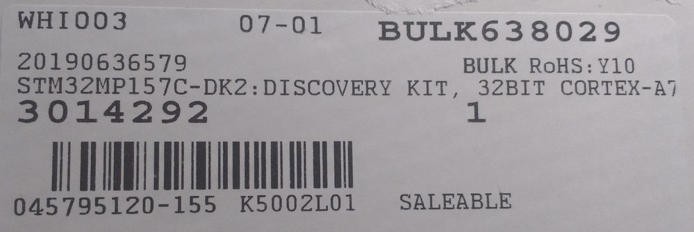

Hi everybody,
I received yesterday the STM32MP157C-DK2, bought on Farnell.
On the back of the board, near the edge, there is a QR Code with content: MB1272-DK2-C01A191500505; there is also a white label, centrally positioned, with content (on two lines): STM32MP157C-DK2 DK32MP157C2$A1
When I first used the board, with the pre-programmed SD, everything worked well, just as in STM32MP1 wiki, Execute basic commands and Use the demo launcher.
Then, I tried to Populate the target and boot the image (Starter Package) but, after that, except for the initial splash screen, the display stays black. The board, in all other aspects, has the same functionalities as before: minicom, ssh, netdata and so on.
Reading this post I have realized that the video could be redirected to HDMI port and I made a test with an external monitor. The GTK demo launcher is just there, on HDMI monitor, and I can also use the touch (black) screen on the board activating commands like Artificial Intelligence or Bluetooth Speaker.
By the way, it's very disappointing to buy a brand new developer board, to follow instructions on the related wiki and to find out that the web official software is older than the shipped one.
Being another unlucky guy (how many are we?) I'm looking forward to the next Major release scheduled for begin of October.
Regards,
Nicola
below the label on the shipped package
