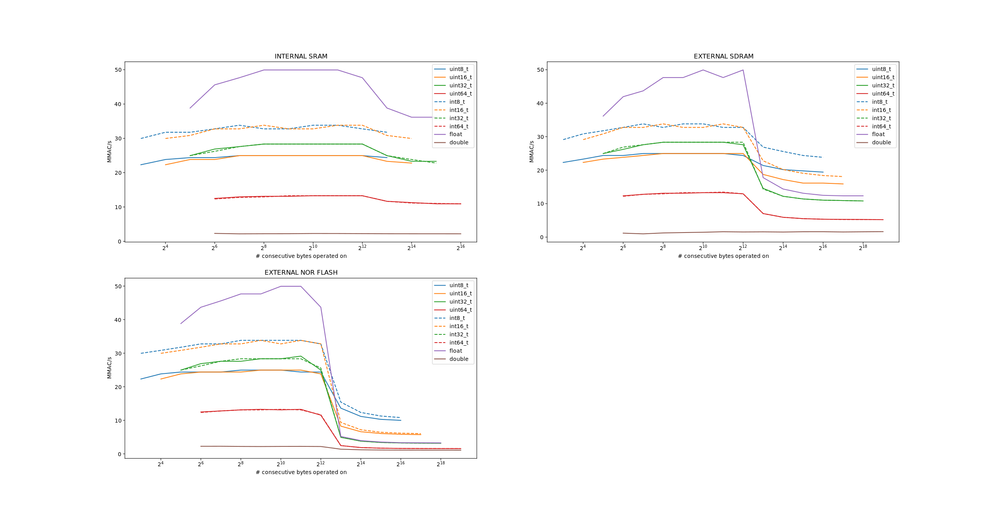

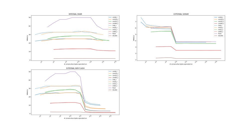

Below is my benchmarking of multply-accumulate performance on contiguous memory blocks on the STM32F7508-DK board for three different types of memory (on-chip SRAM, external SDRAM managed by the FMC, and QSPI-connected NOR flash):
The horizontal axes give the size of the contiguous memory region operated on, and the vertical axes gives the number of millions of multiply-accumulates per second.
One observation that makes sense to me is that performance in all cases drops markedly once the contiguous memory block grows beyond 2^12 B = 4 kiB = the cache size.
The primary thing I don't understand is why the external SDRAM performance is so much worse in the small-size region. Can someone elaborate on this?
The board, SDRAM and NOR flash are all initialized by the STM32CubeF7's BSP functions and templates for the STM32F7508-DISCO board.
While the absolute numbers differ, the overall qualitative behavior is the same across optimization levels from -O0 to -O3.

Diagram looks to show SDRAM is an order of magnitude slow than SRAM, if I'm reading it right.
More likely something in the MPU settings as to whether the memory is bufferable/cacheable

Do you have instruction and data cache enabled? It could be that the larger sizes produce more cache misses. Can you share the actual code being tested?

Exactly. And an order of magnitude slower than the NOR flash. This is indeed what's puzzling me.
I will look into the MPU settings about bufferable/cacheable memory. Thank you for the hint!
