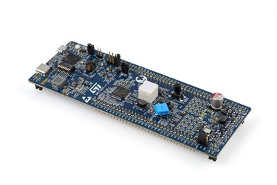

For this tutorial, we use the B-G474E-DPOW1 board, which has a USB Type-C® connector interface. However, the demonstration does not use the USB Type-C® additional features. This board has an STM32G474RET6 microcontroller, and the steps shown here can be easily adapted to any other STM32Gx family. For other families, we will present the necessary changes in the development of this article. The STM32CubeIDE 1.13.1, STM32CubeG4 1.5.1, and the X-CUBE-AZRTOS-G4 2.0.0 releases were used to build this tutorial.

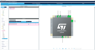

In the next step, we need to enable the USB Peripheral in Device (FS) mode. For this tutorial, the default Parameter Settings are used. We just need to enable the USB low-priority interrupt remap. The high priority interrupt will not work with the Azure ThreadX since it blocks the kernel to run due to the high priority interrupt.

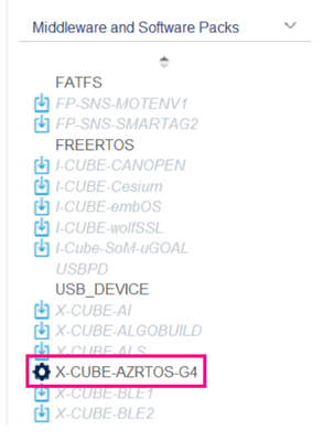

Now, navigate until the X-CUBE-AZRTOS-G4 under the Middleware and Software Packs.

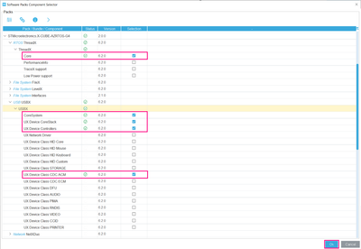

Once clicked on the package, the Software Packs Component Selector menu is opened. There we need to enable the following packs:
After that, press OK.
We enabled the RTOS ThreadX since the USBX was developed to run with the Azure RTOS. It is possible to run the firmware in standalone mode, but we will cover this in another article.

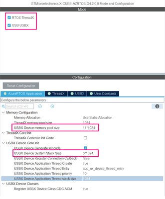

To use the USBX we enabled the CoreSystem and UX Device CoreStack, which contains the middle layer firmware for the USB in device mode that ensures the USB stack processing and the interface between the low and high layers. The UX Device Controllers, low layer firmware to interface with the hardware USB peripheral. And finally, the UX Device Class CDC ACM, the higher layer which includes the class components.
Going back to the STM32CubeIDE, open the X-CUBE-AZRTOS-G4 and enable both RTOS ThreadX and USB USBX. Then increase the amount of memory allocated for the USBX Device System Stack Size and USBX Device memory pool size.

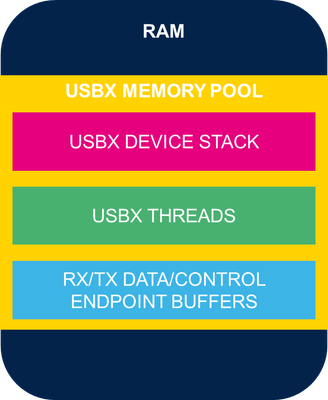

To define the amount of memory for the USBX Device System Stack Size, refer to the table below:

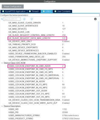

To define the amount of memory for the USBX Device memory pool size, you must take the following into account: USBX Device System Stack Size, the USBX Device Application Thread stack size, the thread stack you are planning to create for the USB application, and the RX and TX buffer.
Navigate to the USBX tab, and decrease the UX_SLAVE_REQUEST_DATA_MAX_LENGTH to save space in RAM, and change the USBD _CDCACM_ENDPOINT_IN_CMD_ADDR to 2.

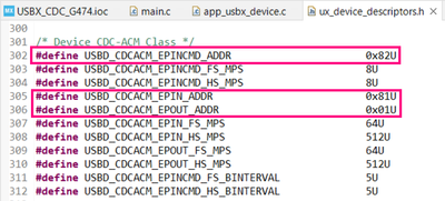

Here, we use the endpoint 0 IN/OUT as the standard control endpoint. The endpoint 1 IN/OUT for the CDC data. And finally, the endpoint 2 IN for the CDC commands. You can change these addresses as you want, just ensure to respect the USB IP capabilities.

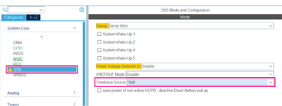

It is necessary to change the Timebase Source, since the SysTick is used the RTOS kernel. To do that, go to SYS and select a timer for the timebase.

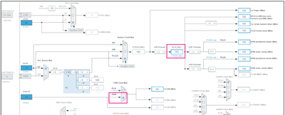

The next step in the configuration tool is to adjust the Clock Configuration. So, go to this tab, select the HSI48 for the CK48 Clock Mux source, and se the HCLK to 170MHz to extract the maximum MCU performance.

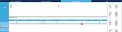

After that, navigate until Project Manager tab, then Code Generator. In this menu, enable the Generate peripheral initialization as a pair of ‘.c/.h’ files per peripheral. This helps us to get access to the USB resources.
The last step is to disable the USB Initialization in the Advanced Settings menu.

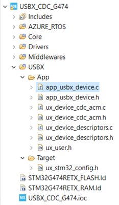

Once the code is generated, we have the following structure:
The first steps in the code development are to link the ST HAL USB driver with the USBX firmware and then initialize the USB peripheral. These steps are done in the app_usbx_device.c file. So, open that and start adding the following includes:

The endpoint addresses are defined according to the selected address in the graphical configuration tool, as presented before. To verify the generated addresses, you can double check the addresses in the ux_device_descriptors.h.

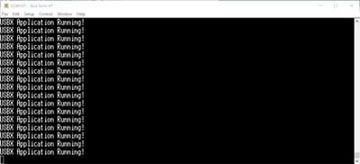

And that concludes our example code. Connect the USB of the STLINK in your board, then the USB Type-C®, start a debug session and see the application running!
Once you have opened the debug session, let the code run and open a virtual COM port terminal in your computer. The “USBX Application Running!” message should be printed on every second. If you send the character ‘1’ the Orange LED should be turned ON, and it should be turned OFF when the character ‘0’ is sent.

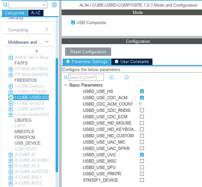

it is a shame that CubeMX does not support a combination of several device classes. After one day of searching examples i found a "software pack" for CubeMX:
alambe94/I-CUBE-USBD-Composite: Create STM32 USB Composite devices with ease. (github.com)
ST, please support this project and promote it, so we all can save lifetime!

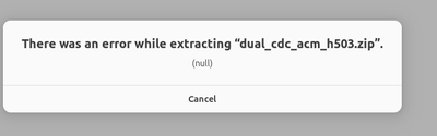

Hi @B.Montanari,
Thank you for the quick response!
I am not able to open the Zip after I downloaded. Can you please upload it again?
> unzip dual_cdc_acm_h503.zip
Archive: dual_cdc_acm_h503.zip
End-of-central-directory signature not found. Either this file is not
a zipfile, or it constitutes one disk of a multi-part archive. In the
latter case the central directory and zipfile comment will be found on
the last disk(s) of this archive.
unzip: cannot find zipfile directory in one of dual_cdc_acm_h503.zip or
dual_cdc_acm_h503.zip.zip, and cannot find dual_cdc_acm_h503.zip.ZIP, period.

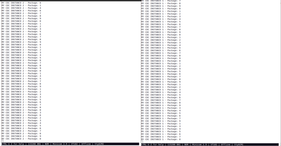

Hi @B.Montanari,
Thank you so much!
I got it working with your example code on STM32WB5.
https://github.com/navinreddy23/USBX_Dual_ACM/tree/BrunoMontanari-Implementation.
But from the original implementation, when I make changes it still outputs gibberish on UART console. https://github.com/navinreddy23/USBX_Dual_ACM
Any idea what could be going wrong? I am not sure if or how UART is being involved when second ACM is added.
