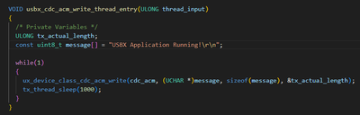

The last modifications are done to the ux_device_cdc_acm.c file, where we add the thread codes:
/* USER CODE BEGIN 1 */
VOID usbx_cdc_acm_write_thread_entry(ULONG thread_input)
 /* Private Variables */
 ULONG tx_actual_length;
 const uint8_t message[] = "USBX Application Running!\r\n";
 while(1)
 ux_device_class_cdc_acm_write(cdc_acm, (UCHAR *)(message), sizeof(message), &tx_actual_length);
 tx_thread_sleep(100);

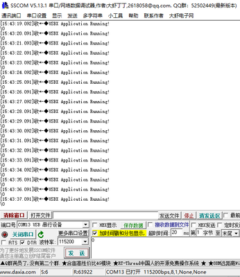

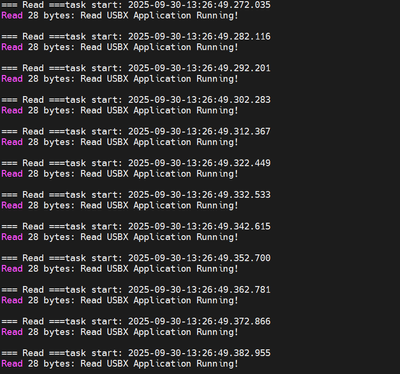

And that concludes our example code. Connect the USB of the STLINK in your board, then the USB Type-C®, start a debug session and see the application running!
2. Results
Once you have opened the debug session, let the code run and open a virtual COM port terminal in your computer. The “USBX Application Running!” message should be printed on every second. If you send the character ‘1’ the Orange LED should be turned ON, and it should be turned OFF when the character ‘0’ is sent.
3. Conclusion
That concludes our article. Now you have the needed information to start developing with the USBX Device stack. The steps for implementing other classes are similar up to the class layer code. In these cases, our GitHub contains a vast set of demonstration projects that includes most of the available classes both for Host and Device applications.
