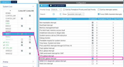

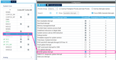

The next step is enabling the HSEM NVIC interrupt for each core:

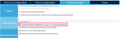

The clock configuration can be kept as default and as a recommendation. An extra configuration that could be a powerful tool to organize the code workspace is to check the option "Generate peripheral initialization as a pair of '.c/.h' files per peripheral" in Project Manager → Code Generator:

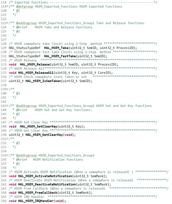

The code is implemented only within the “main.c” files for both cores. Looking at the “stm32h7xx_hal_hsem.h” file, you can check the main functions to use the HSEM, such as take and release:

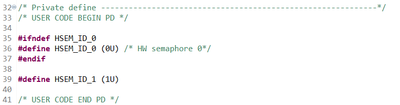

Another thing to mention is that the HSEM is already used by the code for boot purposes. Its ID is already defined at the "Private define" section in “main.c” and this is what we use:

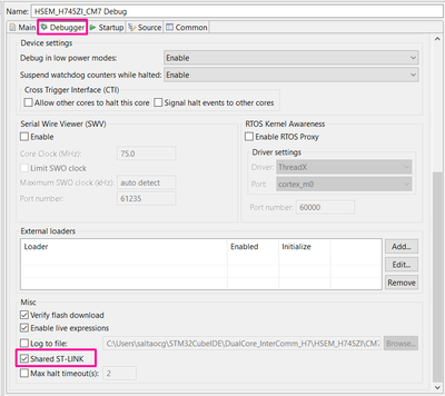

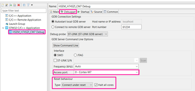

At the end, you can right-click the CM7 project and go to [Run as] → [Run Configurations…] and open the [Debugger] tab. Follow the configurations below:
Scrolling down on the [Debugger] tab, make sure that the [Shared ST-LINK] box is checked:

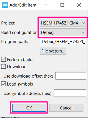

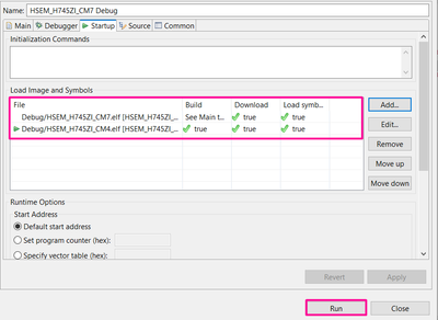

The next thing is to configure the Startup tab. At the Load Image and Symbols section, click on [Add…] and link the CM4 Project just as below:
It should look like this:
Finally, you can check the board’s LED’s status for validation.
