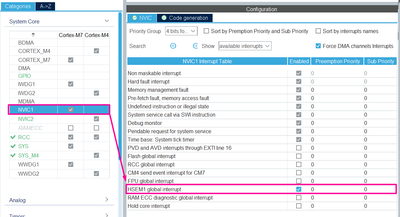

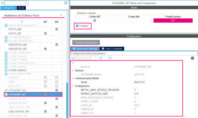

For this application, we need to enable the OpenAMP framework. Go to [Middleware and Software Package] → [OPENAMP_M7] and set the communication mode as Master. Once one of the OpenAMP is enabled, the other one is also automatically enabled. Keep the Parameter Settings as default:

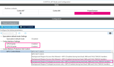

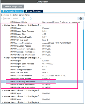

This project also uses the MPU resource on Cortex®-M7. You can enable it by going to [System Core] > [CORTEX_M7] and completing the following configurations for Parameter Settings:

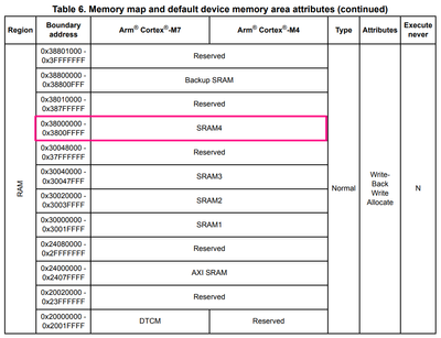

It is important to the MPU Cacheable Permission in [DISABLE] and enable the MPU Shareability Permission. The MPU Region Base Address is according with the SRAM address of your choice. In this case, the address refers to SRAM4.
In this case, the SRAM4 of 64Kbyte from D3 domain was chosen, because it remains available even if D1 or D2 domain are in Low Power mode. You can check the start address at the reference manual:

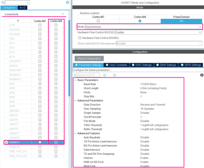

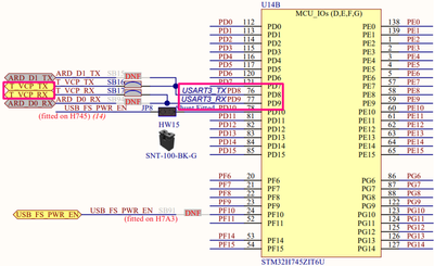

To validate the code, the slave from the OpenAMP framework (Cortex®-M4) sends the data received by the master to the virtual COM port (VCP) USART, which is the USART3 in this board:
So, we need to enable the USART3 in this project as well. Go to [Connectivity] → [USART3] and enable it for the Cortex®-M4 (slave). Keep the configurations at Parameter Settings as default:

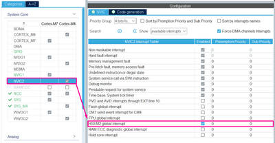

The clock configuration can be kept as default and as a recommendation. An additional configuration that could be a powerful tool to organize the code workspace is: Check the option "Generate peripheral initialization as a pair of '.c/.h' files per peripheral" in Project Manager → Code Generator:

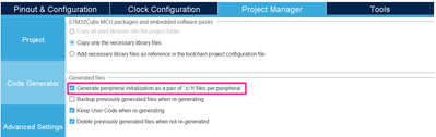

Now that the basic peripherals and settings are configured, we can generate the code and jump to programming.

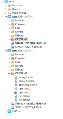

The code is implemented within the “main.c” files and the “STM32H745ZITX_FLASH” linker script file for both cores. Starting with the CM7, go to the “main.c” file and add the following code in each section described:

Now, go to the CM7 “STM32H745ZITX_FLASH” file like and replace the MEMORY definition with:

 HSEM_COMMON->ICR |= ((uint32_t)__HAL_HSEM_SEMID_TO_MASK(HSEM_ID_0));
 HAL_NVIC_ClearPendingIRQ(HSEM2_IRQn);

Now, at the CM4 “STM32H745ZITX_FLASH” file, replace the MEMORY definition with:

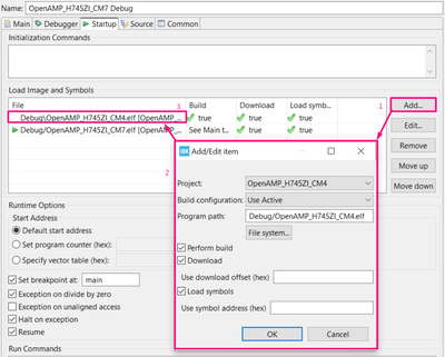

When it is all done, you can build your project. The next step is to configure the debug configurations to each core. Right-click the CM4 project and go to [Debug As] → [Debug Configurations] and double-click the STM32 C/C++ application to create the CM7 debug configuration.
At the [Startup] tab, add the CM4 project in the “Load Image and Symbols” section and configure it as follows by using the [Add…] button, locating the CM4 project. Then, click on the [Apply] button and close the configuration window.
Finally, you can launch the CM7 debugger first and the CM4 debugger after. Then, click on the Resume button (F8) for both projects and check the Virtual Terminal for code validation.

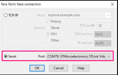

The code is validated through serial communication, via USART3. So, we need a terminal to show the string message. In this case, Tera Term is used as a terminal, but you can use the STM32CubeIDE’s command shell console.
Open the Tera Term window and select the STLink Serial Port (may vary):
Then, go to [Setup] > [Serial port...] and configure as below:
Then, while debugging, you can check the string that was transmitted:
