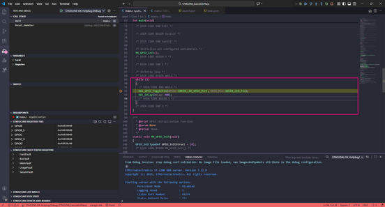

6. Create and modify the launch.json file
  • Open the Run and Debug view (Ctrl+Shift+D).
  • Click create a launch.json file.
The current recommended pipeline is to use the Cortex-Debug extension for STM32N6 XIP debug sessions.
Note: The previous stlinkgdbtarget-based launch configuration is no longer the recommended workflow for this STM32N6 XIP use case.
Edit the generated launch.json to support debugging with all features enabled.

6.1 Explanation of the launch.json file changes
Changed the debug configuration name:
The "name" field was updated from a generic label to "STM32N6-DK / Cortex-Debug" to clearly identify the target board and make the configuration easier to recognize in the VS Code interface.
Main executable set to the FSBL ELF:
The FSBL is the first valid executable after reset. It is responsible for configuring the external memory interface and enabling memory-mapped mode for the XIP application. For this reason, the debug session must start from the FSBL.
runToEntryPoint set to BOOT_Application:
As explained earlier in this article, breakpoints cannot reliably be placed in application code stored in external memory before the FSBL configures the memory in memory-mapped mode. BOOT_Application is the first safe point after this configuration is completed, so it is used as the initial debugger stop point.
Added svdPath:
A new "svdPath" field was introduced, pointing to the SVD (System View Description) file for the STM32N657 device. This enables the debugger to display peripheral registers and improves the debugging experience by providing detailed hardware information in the UI.
Added serverArgs:
The configuration passes additional arguments to the ST-LINK GDB server:
  • “-m”, “1”: This sets the debug server connection mode used in the session.
  • “-el”, “external loader path”: This provides the external loader required to access the external flash on the STM32N6570-DK. Without this loader, the debugger cannot correctly access or program the XIP storage device.
Added overrideLaunchCommands:
The launch sequence is customized with:
  • -target-download: the FSBL ELF is downloaded to the target
  • monitor halt: the target is halted immediately afterward
This ensures that the FSBL ELF is downloaded temporarily for the active debug session and that the target is halted immediately afterward.
This debug download does not replace the trusted images previously programmed into external flash. It is only used to establish the debug session on the FSBL in a controlled and repeatable way.
The trusted images remain necessary because they are the persistent binaries required by the STM32N6570-DK boot flow.
Added postLaunchCommands:
The following command is executed after launch:
  • add-symbol-file <Appli ELF path>
This loads the application ELF as an additional symbol file. In resume:
  • the FSBL ELF is the main executable used to start the debug session
  • the Appli ELF is loaded for symbol resolution only
This gives source-level visibility into the XIP application once execution reaches the application stage, without changing the trusted binaries already programmed into flash.

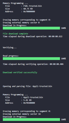

Although the debug session uses the FSBL ELF as the main executable and the application ELF for symbols, the trusted signed binaries must still be programmed into the device before debugging.
This is important because the trusted binaries are the images actually required by the STM32N6570-DK secure boot flow and by other boot modes beyond the current debug session.
In this workflow:
  • FSBL-trusted.bin and Appli-trusted.bin are flashed into external memory using STM32CubeProgrammer CLI
  • these are the persistent trusted images used by the MCU boot flow
  • the -target-download command in the debug launch configuration downloads the unsigned FSBL ELF only temporarily for the active debug session
In other words, the debugger download is session-local, while the trusted binaries flashed by the task are the persistent bootable images.
For this reason, the recommended approach is to flash the trusted binaries first using STM32CubeProgrammer CLI, then start the debug session.

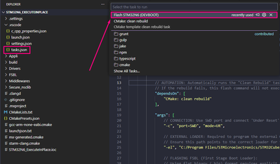

Flash using a VS Code task
Create the following .vscode/tasks.json file:
"version": "2.0.0",
"tasks": [
// This task invokes the STM32CubeProgrammer CLI to program the board.
// REQUIREMENT: Board must be in DEVBOOT mode (BOOT1=1) for this to succeed.
"label": "Flash STM32N6 (DEVBOOT)",
"type": "process",
"command": "STM32_Programmer_CLI",
"args": [
// CONNECTION: Use SWD port and connect 'Under Reset' (UR)
"-c", "port=SWD", "mode=UR",
// EXTERNAL LOADER: Required to program the external memory.
// Ensure this path points to the correct loader for the STM32N6 DK.
"-el", "C:/Program Files/STMicroelectronics/STM32Cube/STM32CubeProgrammer/bin/ExternalLoader/MX66UW1G45G_STM32N6570-DK.stldr",
// FLASHING FSBL (First Stage Boot Loader):
// Using flat binary (.bin) format requires explicit start address (0x70000000).
"-d", "${workspaceFolder}/FSBL/build/FSBL-trusted.bin", "0x70000000", "-v", // Verify after write
// FLASHING APPLI (Main Application):

7.1 Explanation of the task
Explicit SWD under-reset connection:
The task uses "-c", "port=SWD", "mode=UR". This selects the SWD debug port and connects under reset, which is more robust for this type of low-level secure/XIP flow.
External loader:
The task specifies “-el”, “external loader path”. This loader is required to program the external memory device used by the STM32N6570-DK board.
Flashing FSBL and Application signed binaries:
The task flashes:
  • FSBL-trusted.bin at address 0x70000000
  • Appli-trusted.bin at address 0x70100000
The addresses are provided explicitly because the input files are flat .bin images.
This ensures that the binaries are written to the correct locations in external memory.
Running the task
After saving tasks.json, run the task with:
Ctrl+Shift+P → Tasks: Run Task → Flash STM32N6 (DEVBOOT)
This flashes the signed FSBL and application binaries.
Optional use as a pre-launch task
If desired, the flash task can also be called automatically before starting the debugger by uncommenting the preLaunchTask line in launch.json:
"preLaunchTask": "Flash STM32N6 (DEVBOOT)"
If you prefer to manually control flashing and debugging separately, you can leave preLaunchTask commented out and run the flash task only when needed.
8. Start debugging
  • Connect your STM32 board to your PC using the ST-Link debugger.
  • In VS Code, select the debug configuration you created.
  • Press F5 or click the green Start Debugging button.
The debugger starts from the FSBL, loads the application symbols, and automatically runs to:
The code starts in the FSBL application running from an address within AXISRAM2. After the code stops here, press [F5] Continue. The green LED should start blinking on the board.
By pausing the code execution, you can confirm that it is running from the external flash by inspecting the function addresses in the call stack. At this stage, all standard debugging features become available, allowing you to:
  • Set breakpoints.
  • Step through your program.
  • Inspect variables, registers, and memory.
  • View call stacks.
Note: Remember that keeping existing breakpoints between debug sessions can cause failure messages when entering debug mode. If a failure message appears when attempting to enter debug mode, try power cycling the board.

  3. Debug via Hotplug:
    • Press F5 on "STM32N6-DK Hotplug/Debug".
    • Result: Debugging with FLASHBOOT mode (BOOT1=0, BOOT0=0) is now possible.

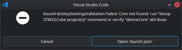

March 6, 2026
Hi @B.Montanari
Thank you very much for this article. It helped me set up VSCode for the STM32N6 Discovery board and also for the Nucleo version of it. I can build the appli and FSBL using the updated CMakeLists and I can also flash them manually with the programmer. However, if I try to use VSCode, I end up with the following error:
bound doStepSettingsValidation Failed: Core not found: run "Setup STM32Cube project(s)" command or verify "deviceCore" attribute
I made the changes to the launch.js but it does not help.
"version": "0.2.0",
"configurations": [
"type": "stlinkgdbtarget",
"request": "launch",
"name": "STM326570-DK Debug",
"origin": "snippet",
"cwd": "${workspaceFolder}",
"preBuild": "${command:st-stm32-ide-debug-launch.build}",
"runEntry": "BOOT_Application", // Set in BOOT_Application
"svdPath": "/home/xx/Apps/STMicroelectronics/STM32Cube/STM32CubeCLT/STMicroelectronics_CMSIS_SVD/STM32N657.svd", // Replace with your .svd path
"imagesAndSymbols": [
"symbolFileName": "${workspaceFolder}/Appli/build/VSCODE_DK_Appli.elf", // Replace this with your path and your_Appli.elf symbol
"imageFileName": "${workspaceFolder}/Appli/build/Appli-trusted.elf",
"symbolFileName": "${workspaceFolder}/FSBL/build/VSCODE_DK_FSBL.elf", // Replace this with your path and your_FSBL.elf symbol
"imageFileName": "${workspaceFolder}/FSBL/build/VSCODE_DK_FSBL.elf", // Replace this with your path and your_FSBL.elf image
"serverExtLoader": [
"loader": "/home/xx/Apps/STMicroelectronics/STM32Cube/STM32CubeProgrammer/bin/ExternalLoader/MX66UW1G45G_STM32N6570-DK.stldr", // Replace with your external loader path
"initialize": false
I have of course also done the 'Setup STM32Cube projects' steps. However I do not know what is meant with 'deviceCore Attributes'.
Do you have any hints on what i could have done wrong?
