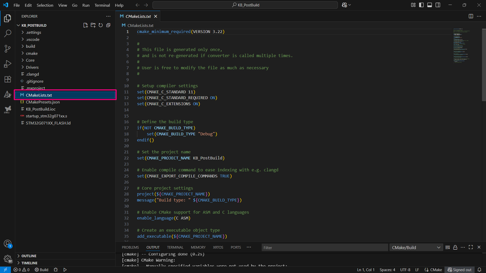

2. Adding post build commands to CMakeLists.txt
Import your project and locate the CMakeLists.txt file in the root of your STM32 project.
Insert the following code snippet at the end of your CMakeLists.txt file:

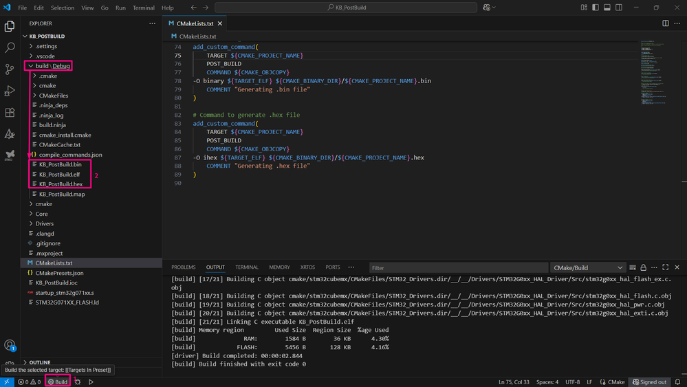

3. Verifying the output
Build the project by using the [Build] button at the lower left corner and after the build completes, navigate to the [build/] directory to verify that the *.elf, *.bin and *.hex files have been generated.
After generating the .bin or .hex files, you can flash them to your STM32 microcontroller using STM32CubeProgrammer to validate the code at runtime.

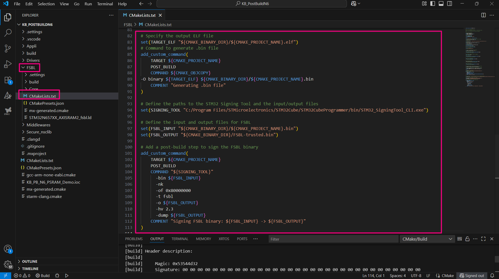

4. Advanced use case: binary signing for the STM32N6 series
On STM32N6 MCUs, the first stage bootloader (FSBL) must be signed so the boot ROM can execute it in a secured-locked state, and same is true for the application. More information can be found on our wiki page: Getting started with STM32N6 security - stm32mcu. However, the steps necessary to execute this process can become repetitive and time-consuming, especially when working on applications that require more than one binary. This portion of the article aims to introduce a simple post build script that allows for the entire signing process to occur after the build is performed.
4.1 Example: signing the FSBL
Since the signing tool will be called every time a new build is performed, it is mandatory to echo the "y" to replace the previous signed binary. A possible way to implement this is shown below, slightly editing the previous commands. Starting from STM32CubeProgrammer version 2.21.0 a new parameter is needed "-align". Please make sure you use the updated command, as follows:
