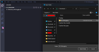

1. Prepare your debugging environment

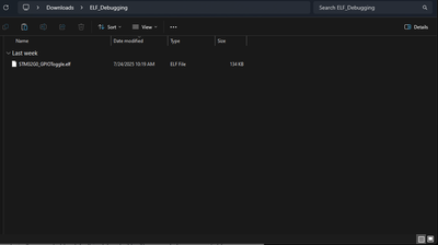

- Create a new folder on your computer and place your compiled *.elf file inside it. In this case, the file is named: STM32G0_GPIOToggle.elf:
- Open this folder in Visual Studio Code by selecting [File] > [Open Folder].
- Ensure your *.elf file includes debug symbols, which are typically generated by default in debug builds.

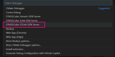

2. Create debug configuration

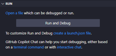

- Open the [Run and Debug] view (Ctrl+Shift+D).
- Click [create a launch.json] file.
- Select [STM32Cube: STLink GDB Server] from the list of debuggers provided by STM32CubeExtension.
- The extension generates a default launch.json file with configurations tailored for STLINK debugging.

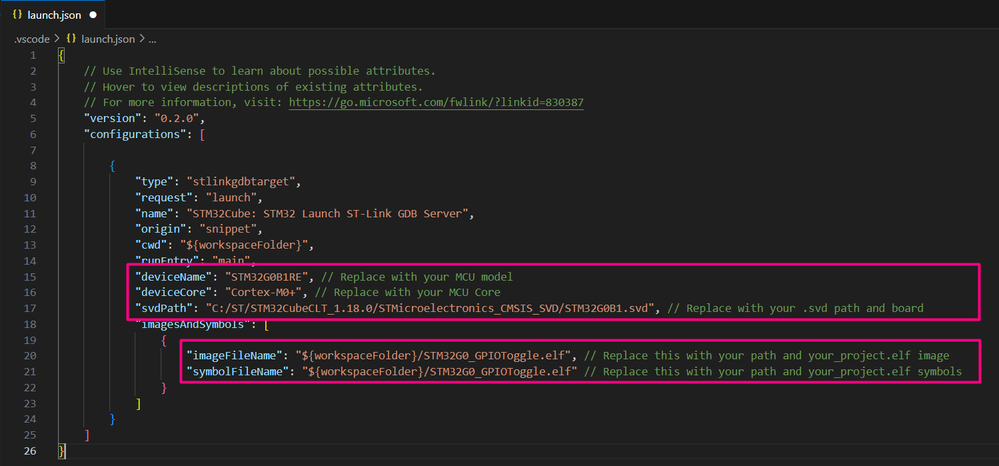

3. Modify launch.json
Edit the generated launch.json file to support debugging with all features enabled. Here is an example configuration for a NUCLEO-G0B1RE:
To facilitate, you can copy/paste and edit from here:

Explanation of the changes:
- Removed “prebuild” command:
Since you are debugging an external *.elf file without a full project or build system, there is no need to trigger a build before debugging.
- Explicit deviceName and deviceCore:
Specifying "deviceName" (for example, STM32G0B1RE) and "deviceCore" (for example, Cortex-M0+) ensures correct initialization, memory mapping, and peripheral support during debugging.
- Added svdPath:
The SVD (system view description) file provides detailed information about the MCU’s peripherals and registers. Including the path to the SVD file enables the STM32CubeExtension to show peripheral registers in the debugger UI, improving visibility and control.
“C:/ST/STM32CubeCLT_1.18.0/STMicroelectronics_CMSIS_SVD/your_board.svd”
- Replaced dynamic program and symbol paths:
The program, imageFileName, and symbolFileName fields now directly reference your *.elf file in the workspace. This is necessary for standalone debugging, as there is no project context to resolve these paths automatically.

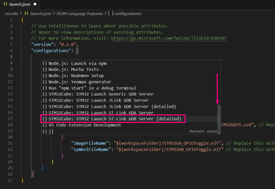

4. Modify launch.json (detailed version)
For advanced options, use the detailed version of the launch configuration provided by the STM32CubeExtension:
- Click [Add Configuration...]
- Select [STM32Cube: STM32 Launch ST-Link GDB Server (detailed)]
Edit the generated configuration to support debugging with all features. You can follow the example below for a NUCLEO-G0B1RE.

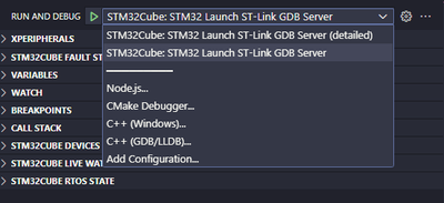

5. Start debugging
- Connect your STM32 board to your PC using the STLINK debugger, the pop-up message appears at the lower right corner, click [Open DEVICES AND BOARDS view]:
- In VS Code, select the debug configuration you created, either the normal or detailed settings:
- Press F5 or click the green [Start Debugging] button.

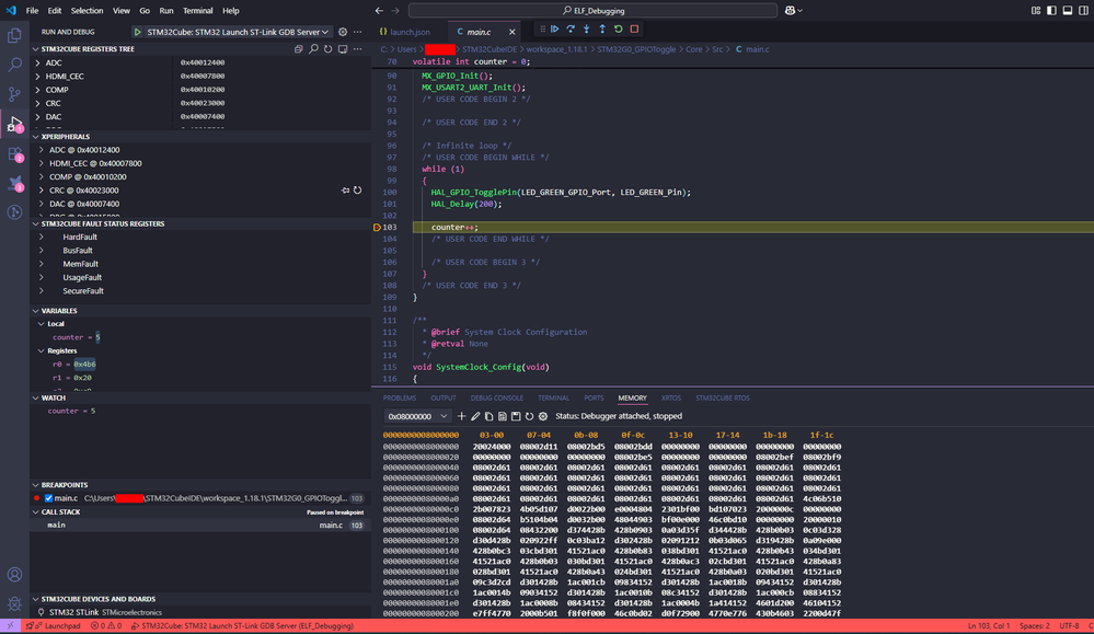

- The STM32CubeExtension automatically connects to your board, load the *.elf file, and halt at the main() function (if runEntry: “main”).
- You can now:
- Set breakpoints in your source code.
- Step through your program.
- Inspect variables, registers, and memory.
- View call stacks.

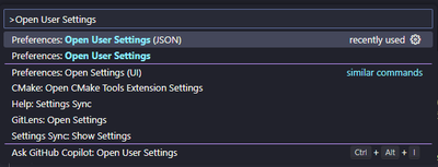

6. Troubleshooting: memory viewer not updating
When debugging with the STM32CubeExtension using the “stlinkgdbtarget” type, you may encounter an issue where the “Memory Viewer” in VS Code does not display memory contents or fails to update during your debug session.
By default, the MemoryView extension may not include "stlinkgdbtarget" in its tracked debuggers in the settings.json file. Without this, the debugger cannot properly read memory, causing the memory viewer to remain empty or stale.
To resolve this:
- Press Ctrl+Shift+P, type Preferences: Open User Settings (JSON), and select it.
- Add the following configuration snippet:
"memory-view.trackDebuggers": [
"stlinkgdbtarget",
- Save the file and restart VS Code or press Ctrl+Shift+P and issue the command to Reload Window:
