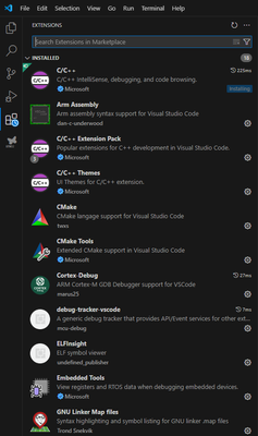

1. In the VS Code application, open [Extensions] (Ctrl + Shift + X).
2. Install the [STM32 VS Code Extension]. It will look like this picture below.

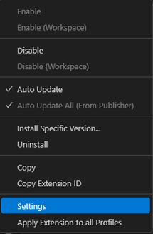

4. Select the cogwheel [Settings] icon for the VS Code Extension.
5. After selecting the icon, select [Settings] from the dropdown menu.

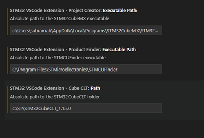

6. Add the paths of the below applications installed on your PC.
  • STM32CubeCLT_1.15.0
  • STM32CubeMX.exe
  • STMCUFinder.exe
Now, you have completed configuring your VS Code IDE for development with STM32 MCU.  You only have to configure this one time. Moving forward, your settings are saved.

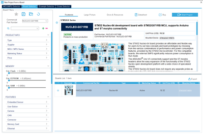

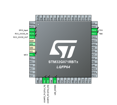

2. Select the board that you would like to develop with. In this article, we use the NUCLEO-G071RB.
3. Configure the peripherals for your application. You won’t need to change any configurations for this demonstration but note that PA5 is connected to the green LED.

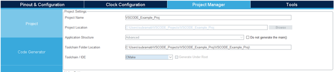

4. Once you have finished configuring your peripherals, select the [Project Manager] tab.
Here, you can name and designate a folder for your project. Make sure to select [CMake] for [Toolchain/IDE].
5. To generate the files needed for the project, select [Generate Code].

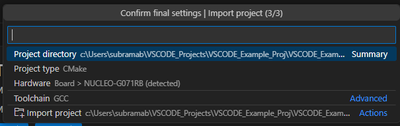

6. Once you’ve generated the CMake project, return to the VS Code IDE. Under the STM32 VS Code extension, select [Import CMake Project] and select the folder you created in STM32CubeMX.
7. After selecting the folder, you’ll have to specify your [Project type] as [CMake] and specify the hardware as NUCLEO-G071RB. Then you can select [Import Project] to finish importing the CMake project to VS Code.

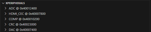

The [Xperipherals] window allows you to monitor peripherals by displaying their configuration registers and address space.

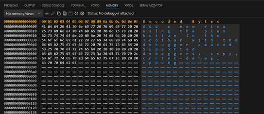

The [Memory Viewer] allows you to monitor memory contents while debugging.
