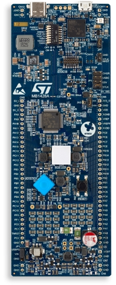

To show an implementation of the EF (Event Flag) resource, this article uses the RGB LED and joystick buttons available on the STM32G474 Discovery kit. Hence, an event flag group is created, where each bit is associated with a joystick button. The flags are set by the EXTI (External Interrupt) callback function, which checks which button has been pressed. To manage the LED color, three timer channels in PWM mode are associated with each signal LED pin.
According to the flag set, two threads manage the PWM timers changing the timer capture compare registers, and the following functions are implemented:

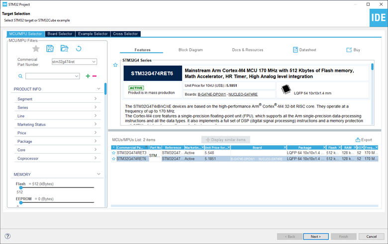

Let us start creating a new STM32 Project on STM32CubeIDE for the STM32G474RET microcontroller.
Name your project, remember to avoid space and special characters. The name used in this article is “EV_FLAG_G474”.

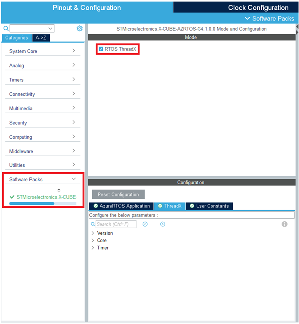

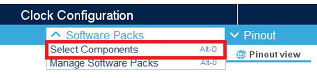

To import the Azure RTOS to the project, click on “Software Packs”, and then “Select Components”.

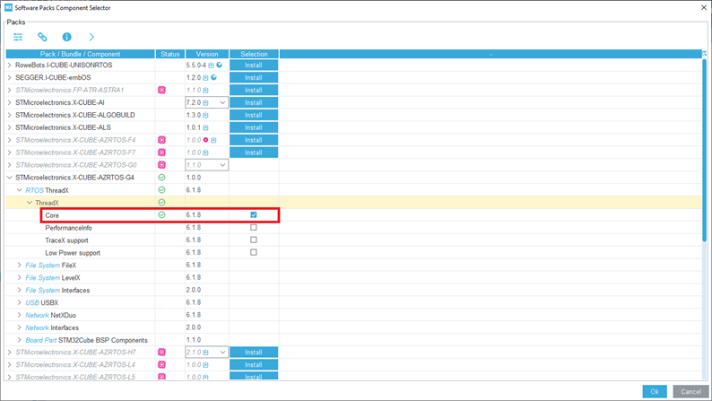

In the “Software Packs Component Selector” menu, locate STMicroelectronics.X-CUBE-AZRTOS-G4 → RTOS ThreadX → ThreadX, check the “Core” box and click OK.
Add the Azure RTOS ThreadX checking the box inside Software Packs → STMicroelectronics.X-CUBE-AZRTOS-G4. As this demo is just meant to create small timers and GPIOs managements according to the event flags, the default settings are fine.

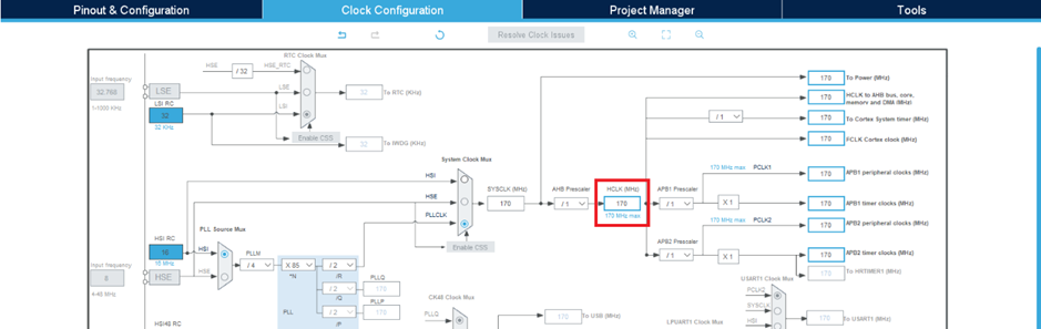

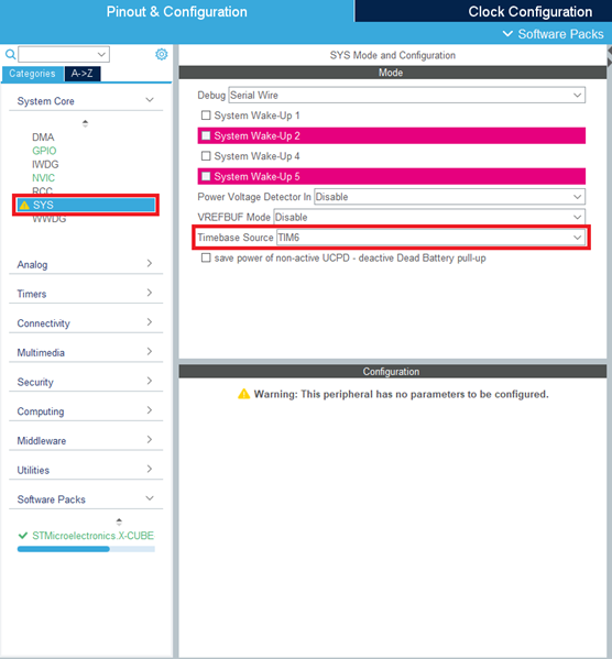

By default, the HAL driver uses the SysTick as its primary time base, but this timer should be left to the AzureRTOS only. If the HAL library does not have a separate time source, the compilation and code execution might fail because both libraries want to use the SysTick_Handler interrupt. To prevent this, we can simply select a different time base for the HAL by clicking in the System Core → SYS and selecting the time base Source as TIM6:
Go to clock configurations and adjust the settings as shown in the image to achieve the HLCK at 170 MHz.

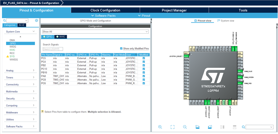

Configure the following pins as table shown:
| Component | Pin | Configuration | Label |
| Joystick Select | PC13 | GPIO External Interrupt mode with Falling Edge trigger detection and pull-up | JOYSTICK_SELECT |
| Joystick Up | PB10 | JOYSTICK_UP | |
| Joystick Right | PB2 | JOYSTICK_RIGHT | |
| Joystick Down | PC5 | JOYSTICK_DOWN | |
| Joystick Left | PC4 | JOYSTICK_LEFT | |
| RGB LED Red | PC6 | TIM3_CH1 | PWM_RED |
| RGB LED GREEN | PC8 | TIM3_CH3 | PWM_GREEN |
| RGB LED BLUE | PA8 | TIM1_CH1 | PWM_BLUE |

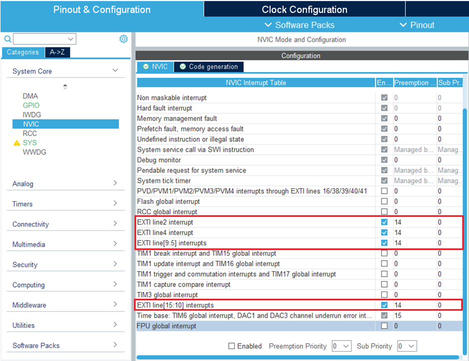

Enable the GPIO External interrupts on NVIC tab and give them a 14 Preemption Priority (this priority will be 1 level lower than thread priorities).

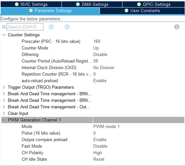

Set timer 1 and 3 configurations as the following settings:
The other settings are default values.

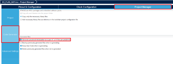

The last step before the code generation is to enable the “Generate peripheral initialization as a pair of ‘.c/.h’ files per peripheral” in Project Manager → Code Generator. This should be helpful to HAL functions and resources management.

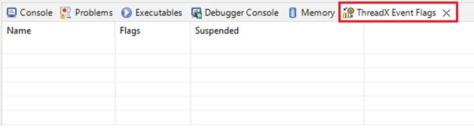

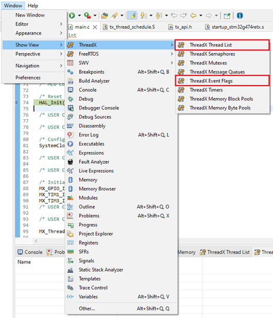

In the Debug Configurations menu, let the standard settings and then click on debug. Once in the Debug perspective, click on “Window → Show view → ThreadX → ThreadX Event Flags”.
It should open a tab at a bottom window group of STM32CubeIDE.

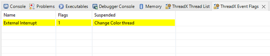

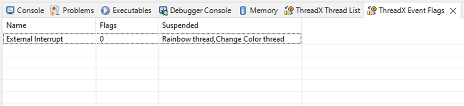

Run the code, test the demo by pressing the buttons and enjoy the RGB LED behavior. Pause the code in the Debug, and check the ThreadX event flags tab. In this tab, you can see the created event groups, their actual flags counting, and the threads that interact with that. Since this code clears the flag after the color update, the flag should be zero if you pause the code when the LED is not in rainbow mode. Furthermore, the threads are suspended because these are waiting for an event.
If you pause the code during the rainbow mode, you see a flag set. The Change Color thread is suspended and the Rainbow thread runs continuously, updating the LED color.

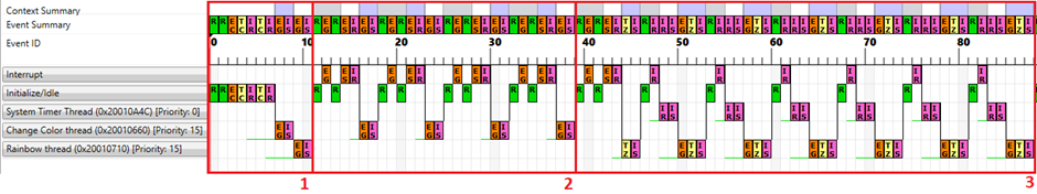

The following image shows the behavior of the OS, it is possible to check how the application works.
In the first block, we have the kernel initialization, the Event Creation (EC), two Thread Creations (TC) and after their first Event Gets (EG) as programmed.
The second block, we can see an EG at the interrupt level (it is the event get inside the EXTI callback function, that is, a button was pressed), then an ES that set a flag bit (also inside the EXTI callback). After the flag is set, the Change Color Thread runs, gets and clears the flag, changes the LED color, and then enters in suspend mode waiting for a new Event. This cycle occurs four times, the same as shown in the previous image.
The third block shows the AzureRTOS kernel behavior when the LED is in Rainbow mode. At the beginning of the block, we have an event get and set (in the EXTI) and then the Rainbow thread starts to run. As we can see, this thread runs continuously because it does not clear the flag to keep the thread running and updating the color of the LED.
This graph was made by the TraceX feature. If you need more information about TraceX and a tutorial showing how to implement this, refer to: How can I add TraceX support in STM32CubeIDE?
