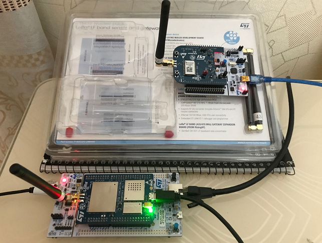

Why the tx is running persistly (the gateway works fine), using P-NUCLEO-LRWAN3 development suit and STM32CubeExpansion_LRWAN_V1.3.1software package.
WLin.1
I'm currently trying to run End_Node project on my P-NUCLEO-LRWAN3 sensor board, I loaded the workspace to my EWARM IDE from STM32CubeExpansion_LRWAN_V1.3.1\Projects\STM32L073RZ-Nucleo\Applications\LoRa\End_Node\EWARM.
Problems
(1) I download and run the firmware to the NUCLEO-L073RZ NUCLEO development board, and reset the board, I got a LORAMAC_STATUS_BUSY and PHY txTimeOut message.

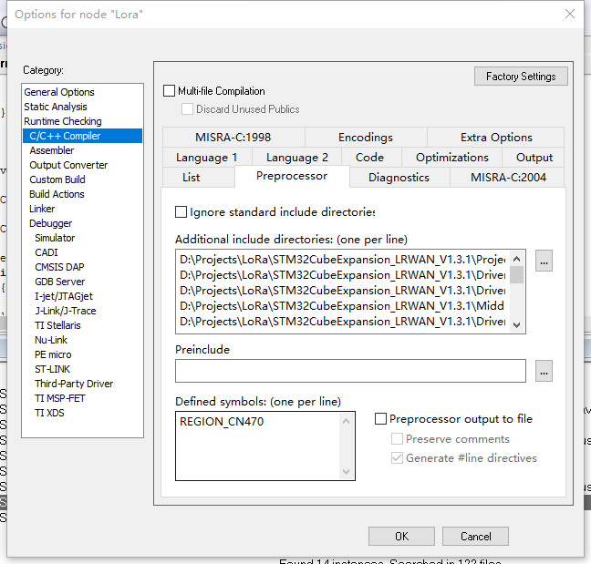

What I have done:
  1. in hw_conf.h, uncomment #define DEBUG and #define SENSOR_ENABLED
  2. In the IDE, Projece/Options/C /C++ Compiler/Preprocessor, I define a symbol as REGION_CN4700693W000000UAI0QAO.png
  3. in comissioning.h, config the OVER_THE_AIR_ACTIVATION/ DEVICE_EUI/JOIN_EUI (AppEUI)/ APP_KEY, other fields are left using default value.
