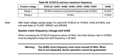

The maximum SYSCLK is 100MHz for voltage scaling range 1 and 16Mhz for voltage scaling range 2:

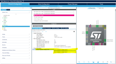

So, to be able to have a SYSCLK up to 100MHz, you need to change the voltage scaling range from 2 to 1:

    I open a ble_beacon project in STM32Cube_FW_WBA_V1.2.0 which adapted for NUCLEO-WBA55CG。
   The default SYSCLK and HCLK1 is 16MHz, when i changed the System Clock Mux to PLLCLK,  Then SYSCLK is up to 64MHz,the STM32CubeMX noticed me that the System Clock must be <= 16MHz。
  Why the STM32CubeMX noticed this error?
