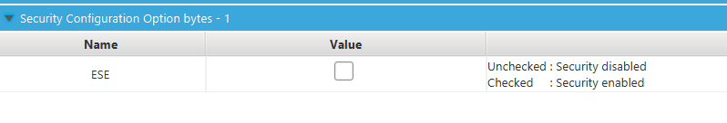

I am using the STM32WB55RG MCU, Bluetooth feature with stack version 1.13.0 and FUS version 1.2.0. Everything was working normal until I tried doing the firmware upgrade of stack from v12.0 to v13.0. I am not able to perform FUS related operations. The version reading shows 0.0.0 for FUS. And following is the log when I hit "Start FUS"

Following is OB info attached. Cube programmer version I am using is : v2.9.0
What could be the issue, please let me know how to resolve FUS and start wireless stack successfully ?

2023-05-15 12:14 AM
ESE option byte is unchecked meaning tis board is not populated with a FUS. So no way to use it to load any new version of FUS or wireless stack.
This board should be a very old one as only the very first boards were shipped unsecure.
2023-05-15 12:16 AM
When a board is secure (ESE bit set), the FUS version is written at address 0x20030030 when the board is connected via USB in DFU mode.

2023-05-15 4:41 AM
Unfortunately, not.
You can still use it to load an application but without RF functionality.
