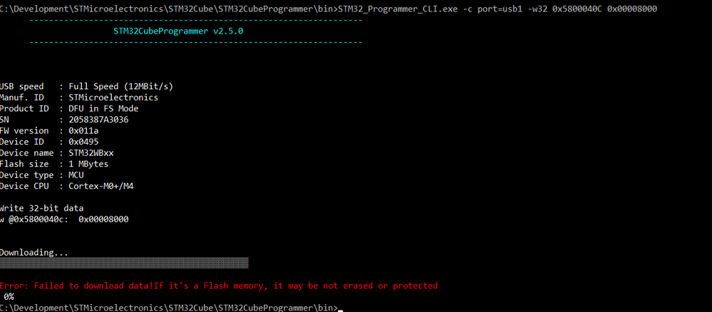

How ti correct write data to address ?
I use:
STM32_Programmer_CLI.exe -c port=usb1 -w32 0x5800040C 0x00008000
but get error:
Remi QUINTIN
​Could you download all the sections of the options bytes or call the command STM32_Programmer_CLI.exe -c port=usb1 -ob displ and give me the log?

Remi QUINTIN
​Ok nothing wrong regarding the option bytes except this puzzling ESE set to 0.
Regarding the marking, I would be interested in the one on the failed chip.
