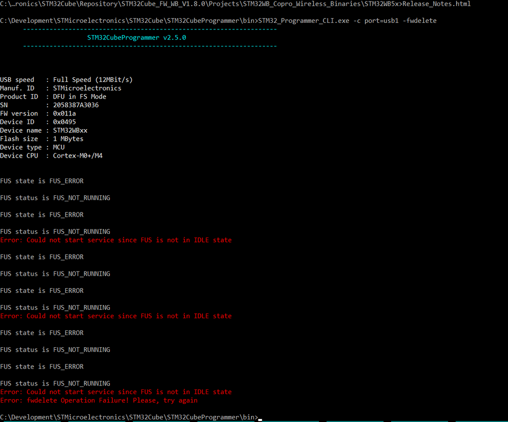

STM342WB55 after load last BLE stack (1.8.0) I can`t erase fw with STM32CubeProgrammer
Vyacheslav
Senior II
Hi.
Using STM32CubeProgrammer I load last stm32wb5x_BLE_Stack_light_fw.bin, but when after that I try to run command -fwdelete, I get an error : "FUS_NOT_RUNNING".
I attach log file becose Idont understand whot is this.
But me application work fine and I see that stack is a last version.
Please help whot may bee .
I send call:
STM32_Programmer_CLI.exe -c port=usb1 -fwdelete -vb 3
65 REPLIES 65
Value at 0x20030030 -- FCD91B10.
Remi QUINTIN
​ouch!!  quite weird value!!
In fact, the ESE option byte is not checked so this device is not secure. No FUS is loaded on your chip.
So you won't be able to use it to install new FUS or any RF encrypted RF stack.
It may be a very old device (very early version).
Where did you get it?
Sorry, Remi, but before download a new stack (1.8.0) everything worked fine and last stack was 1.7.0. and FUS is 1.1.0.
And now chip continue working fine and stack now 1.8.0.0.5 and FUS 1.1.0
This info I get in me application fw by "SHCI_GetWirelessFwInfo".
But now I cant delete or reload any stack - this is a problem.

Remi QUINTIN
​Really? So you manage to upgrade your device with FUS 1.1.0 and then the BLE light RF stack from V1.8?
This is amazing as this can only happen on a secure chip => ESE = 1.
Now the ESE = 0 but normally no one (except CPU2) can reset it to 0.... I am quite puzzled by this situation.
Could you to perform a fwdelete again and read the FUS version?
Can you try then to set ESE back to 1 and retry to read the FUS version?
Yes!
"Could you to perform a fwdelete again and read the FUS version?" - problem in my topic :) afyer loading last stak (1.8.0) I can`t delete.
Log on the zip - it is a dump of "fwdelete" command.
Ok, I try again and send you log.
Remi QUINTIN
OK so we can consider the FUS is V1.1.0. In last resort we could try a trick that would revert the chip to its manufactory state. But this would erase any data in flash memory except the FUS.
First let's wait for your trial.

Remi QUINTIN
As you can see, it is not possible to modify the ESE bit. This is why I am quite puzzle by the fact you were able to load a new fus and run an application.
This can only be done with ESE = 1 and once set to 1 there is no way to revert it to 0.
I would say that this chip is too old from an early not secured version on which you can only run application but without any RF stack.
Are you really able to advertise and be detected by a mobile application like the STBLE sensor android application?
if calling SHCI_GetWirelessFwInfo function still gives you FUS v1.1.0, then you could try to revert to the manufactory state (no guarantee it would work with your case).
Write 0x00008000 at address 0x5800040C and then reset your chip.
Let me know if it allows you to program it again.
