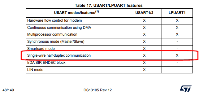

Andrew Neil
@DavidG7 wrote:
Is this a device limitation ?
You need to look at the device Datasheet and Reference Manual: they will show you all the available Alternate Function pin allocations - see if any of them works to get access to all 3 UARTs ...

STTwo-32
According to the datasheet, they both support single-wire half-duplex:
@DavidG7  - Maybe if you do that, one could use each pin ... ?
:thinking_face:
@Andrew Neil
On the one wire (Half-duplex) mode, both need to enable the TX pin. this pin is the same for both of them (PA2).
Best regards.
