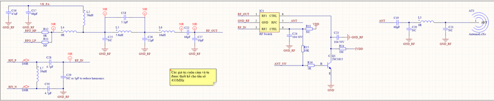

I created Lora project which send and receive data. I designed my board, no TCXO.
My schematic:

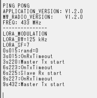

0693W00000UFQ6yQAH.pngMy result:
0693W00000UFQ2IQAX.pngthe random value is 0, TxTimeout everytime.
I replaced to new MCU, new RF switch IC but result not change. Please support me.
Thanks.

I have the other board the random value is not 0 but the LoRa Tx status is always TxTimeout.
I follow the Ping Pong example project. I soldered the R12 resistor to choose LP LoRa communication, my project work correctly but I soldered the R13 resistor to choose HP LoRa communication, the LoRa Tx status is always TxTimeout
