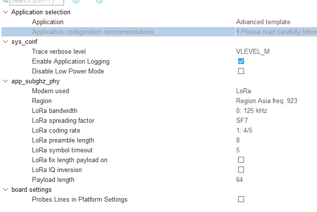

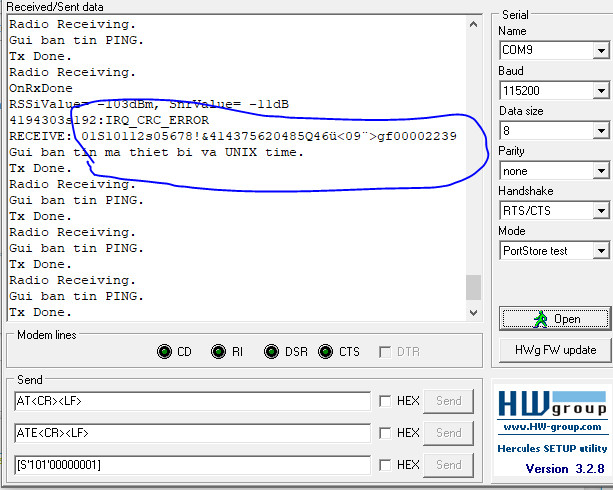

I created my project which send or receive data through LoRa. This is my result:0693W00000UFHdoQAH.pngThis is my configuration:
0693W00000UFHdtQAH.pngCan I fix in my firmware ? Please support me.
Thanks.

Hello @ngodoanvan ;
Try to improve range by increasing the LoRa Spreading Factor (SF) and dropping the bandwidth.
Imen
