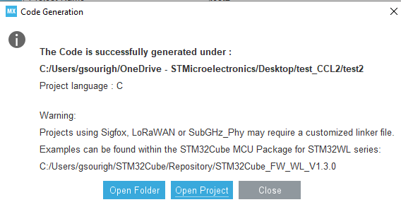

we want to use the STM32WLE55 MCU in the AI50H Module to build a Node to Node connection in a LoRa Network.
So i used the STM32CubeMX Program to build an easy solution that includes only "UART", "SUBGHZ" and "SUBGHZ_PHY" modules.
Goal is that i send a sensor value per UART and the STM32 sends this data over Lora.
So i have several problems:
  1. STM32CubeMX told me to change the linker file because "subghz_phy" is active? what is there to change?
  2. i have (in the fresh generated file) several errors after building.. "<file_path>: Invalid Argument" and "fatal error: no input files"
can someone help me what i am doing wrong?
Sorry for providing not that much information, this is a totally new created project.

Ghofrane GSOURI
Hello @steven Drägestein​
Actually I tried to reproduce the issue mentioned above :
I used the CubeMX 6.8.0 and the STM32WLE5 MCU : I activated the "USART1", "SUBGHZ "and "SUBGHZ_PHY": this is what I got after generate the code
_legacyfs_online_stmicro_images_0693W00000bhiKnQAI.pngAfter building the generated code
You will find below my ioc .
I will be waiting for your feedback to understand more the situation .
Thx
Ghofrane

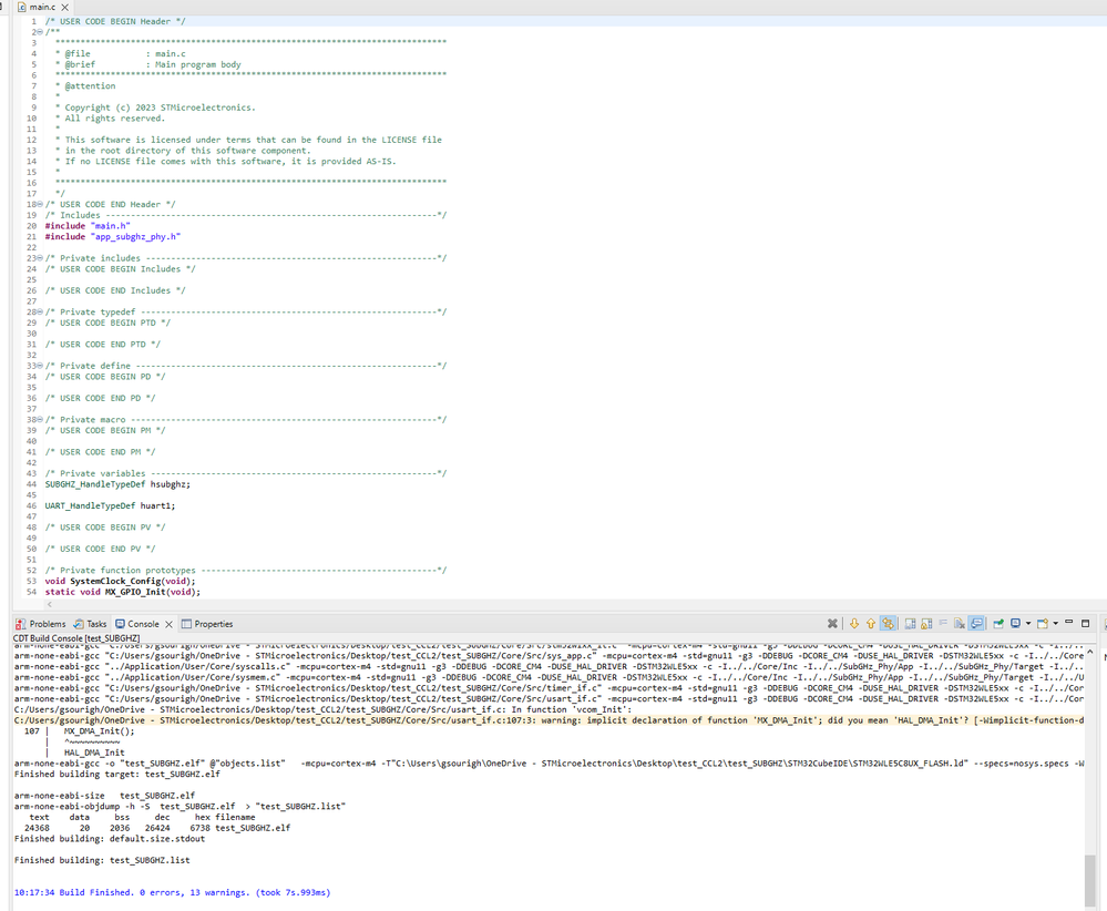

Draegi
Hello Ghofrane,
thanks for your fast reply.
I downloaded your .ioc file, did generate Code with STM32CubeMX and opened the .project File in STM32CubeIDE.
Then i tried to build the project and got 9 Errors, 0 Warnings.
f.e.:
arm-none-eabi-gcc: error: C:/Users/Steven Dr??gestein/Downloads/Utilities/sequencer/stm32_seq.c: Invalid argument
arm-none-eabi-gcc: fatal error: no input files
Its pretty much the same issue like i had in my recent test projects..
I also uploaded a screenshot of the console. Text above are the same errors in different files.

Draegi
Hello @Ghofrane GSOURI​
I also used Cube IDE 1.12.0
Even if i create a totally new project in the Cube IDE, i get the same Error with the Linker File "STM32WLE5CCUX_FLASH.ld"
No such file or directory.
I will reinstall CubeIDE
Draegi
i think i fixed the problem.
My windows profile has an "ä" inside, and i tried an other windows profile "admin" and it works...
