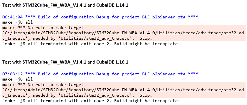

You wrote: Please use the STM32CubeWBA V1.4.1 (the last version). I tried, but i know, that there are still bugs with STM32CubeWBA V1.4.1.

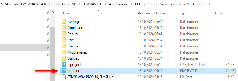

I startet the project directly from the regarding project file in the FW-Package:
But i got these error messages:

Hello @STTwo-32
Now I have done the steps (with CubeIDE 1.4.0 and FW-Package 1.2.0) as you suggested.

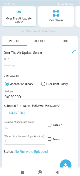

Then I opened the ST BLE Toolbox on my Android phone and established a connection to the board. So far everything is OK. Then I started the OTA update with the file BLE_HeartRate_ota.bin.
The upload starts and I get the message upload complete. Unfortunately nothing has changed. BLE_p2pServer_ota is still active.
