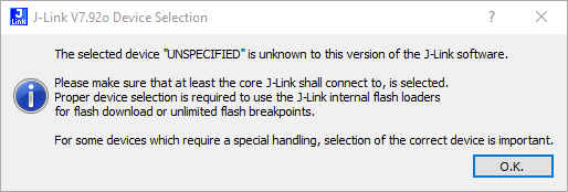

Then I changed the settings in STM32_WPAN configuration (Change BLE Stack from Basic to Full). I generated the code and compiled it.Then I tried to flash the new .bin file of the BLE_p2pServer_ota @ start address 0x0800 6000 and got this message:

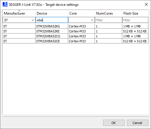

However, the controller (STM32WBA55CG) is not listed in the settings:

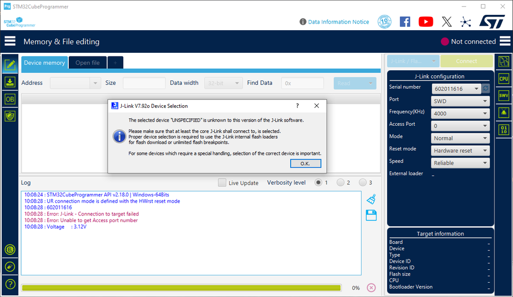

And therefore, I am no longer able to establish a connection to the controller with STM32CubeProgrammer:

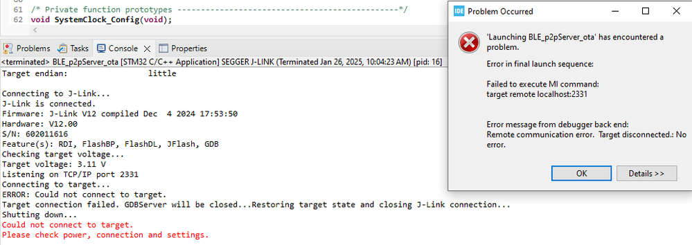

Then I tried to establish a connection with STM32CubeIDE, but that also failed:
Does anyone have any ideas what I can do?

‎2025-01-27 1:59 AM
I have found the cause.
As soon as I set the low power mode in STM32_WPAN configuration to
I have found the cause. As soon as I set the low power mode, I lock myself out. I think I can get access again if I set the Boot0 pin to high as soon as I connect to J-Link.
