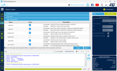

I've connected the MCU USB to my computer and showed that the MCU is in DFU Mode even though BOOT0 is pulled LOW.
Another strange thing is that Option bits are assigned strangely.
I've uploaded the code in the attachments via USB DFU mode and the Code has worked perfectly.
However, I cannot program it again even via SWD or DFU which is very strange behavior.
The board consumes around 10mA in DFU or Runs the code in the attachments.
