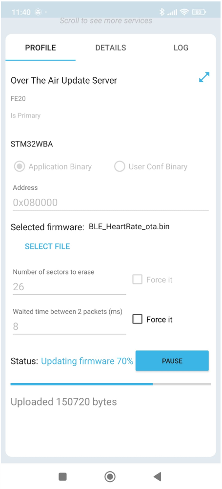

I am using the NUCLEO-WBA55CG board with CubeIDE1.4.0 and the firmware package STM32Cube_FW_WBA_V1.2.0.

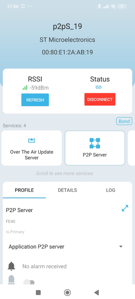

BLE_p2pServer_ota is running on my NUCLEO board. When I start the OTA update, the firmware is uploaded and completed. But after the upload nothing has changed. The BLE_p2pServer_ota is still running and the MAC address has not increased by 1.
_Joe_
Hi Ledi,
I've just tested with a p2pServer OTA and a HeartRate OTA the Cube FW v1.2.0, everything works fine on my side.
I'll attach my binaries for you to test.
You can also check that you have the latest version of ST BLE Toolbox (v1.4.2).
BR, Joé
