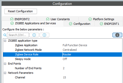

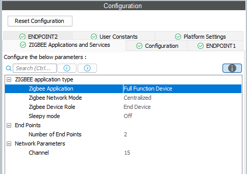

I work on a simple config with stm32CubeMX with 2 endpoints on stm32wba54kgu6,
Endpoint 1 with cluster on/off receiving command client
Endpoint 2 running as cluster temperature server.
I use ZigbeetoMqtt coordinator.
When i use router mode, i can discuss with stm32wba54 and it's run well.
When i use end device mode, no answer. (tried with FFD and RFD)
in 2 case, the join and interview is ok.
Strange ??
It's ok with this
And no respond at all with this (include basic cluster)

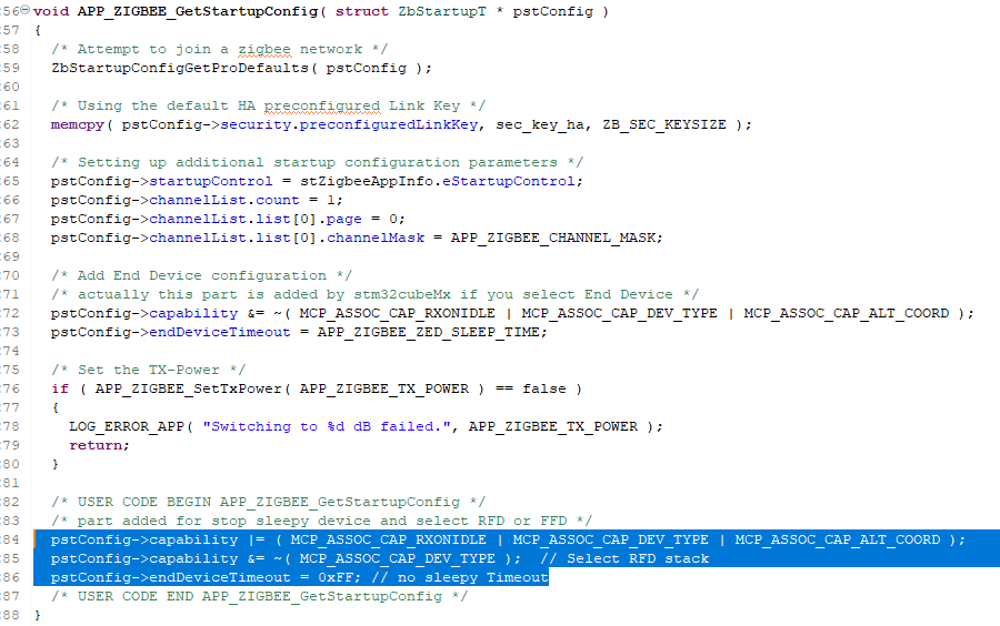

2024-06-19 7:10 AM
I understand your answer.
Actually Stm32CubeMx does not configure correctly because when I select "End Device", it automatically configures in sleepy mode with timeout and Reduced Function Device, while these choices do not appear in the configuration menu. This can cause confusion for users.
Can you inform the team of this problem ?
Some EndPoint application need no sleepy mode with use of RFD library for minimize the flash space used.
If i add this code in app_zigbee_endpoint.c, the component run correctly now :

Looking at Wireshark capture for End device configuration, it seems that the device goes to sleep mode after the join and the Timeout negotiation, in this case, the End device will not handle any Read command until it wakes up again and sends the poll data request.
Actually, End devices are intended to be sleepy: RxOnWhenIdle=false, Otherwise it is more practical to make the device a router as the Rx is always ON.
For Sleepy end devices such a Temperature sensor, the measured values is sent over reporting attribute during the poll timeout, no need to send read request which increases the consumption.
