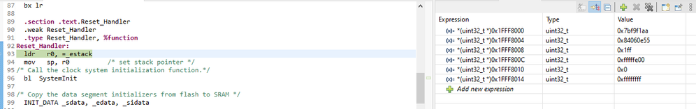

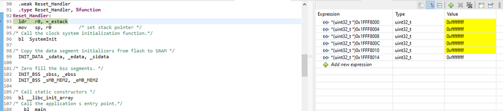

Some strange behavior is happening when debugging our firmware through STM32CubeIDE, where it erases the option bytes upon flashing the firmware (0xFF @ 0x1FFF8000 onwards). The debugging session still launches ok and the firmware appears to be flashed correctly and working as intended.
This is especially annoying as it triggers the flash option bytes protection where it secures the memory and I have to manually restore it using the FUS safe boot mechanism. Our firmware is designed to go to shutdown mode each time which triggers this, so I can't do any work on it right now.

  • Stopping on the very first instruction and inspecting memory - the OB's are erased even here!
Dummy firmware:
Real firmware:
0693W00000Y7NMyQAN.pngAny ideas? Thanks
