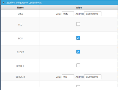

Please, can you share Option Bytes values of your Nucleo dongle?
Specially SFSA, FSD, C2OPT, SBRV (in "Security Configuration Option bytes") and ESE.
It will give us an idea of how the device is configured.
Best Regards,
Alan Porte
ST MCU Support Team
Alan
ESE  -  checked
SFSA  Value=0xF6, Address = 0x080F6000
FSD  -  unchecked
C2OPT - Checked
DDS - Checked
NBRSD Unchecked
SNBRSA: Value=0x19, Addr = 0x2003C000
BRSD - Checked
SBRSA  - Value=0x0, Addr = 0x20030000
SBRV Value=0x3D800, Addr = 0x003D80
Thank you.

Alan PORTE
Many thanks for the data.
Look like your device is still with FUS v0.5.3
I don't see any corruption, thus from my perspective the device is not damaged.
However, I just noticed on your screenshot that the FUS file stm32wb5x_FUS_fw_for_fus_0_5_3.bin you are trying to download doesn't have the correct size.
I read Size=276KB, which is too big.
Extract from your screenshot:
Correct size of the file is around 24KB.
