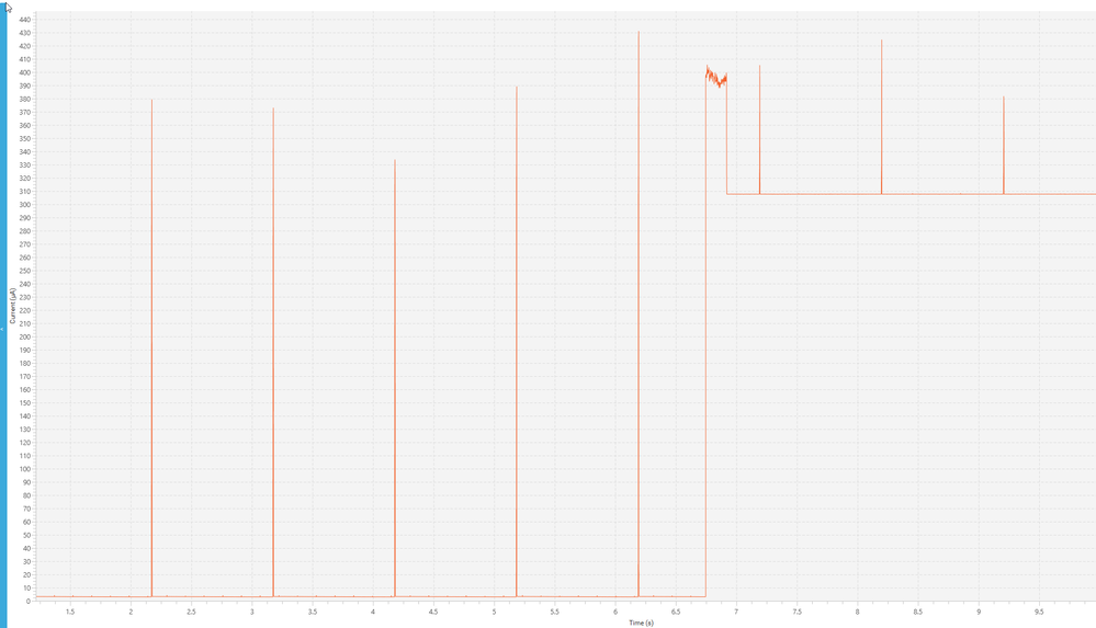

I am using STM32WB55CEU6, when using EXTI callback with BLE and LPM enabled, the MCU never enters the desired STOP2 power mode. The callback triggers every 20 seconds and is used to set a task by calling UTIL_SEQ_SetTask(...).
When a virtual timer is used (no EXTI callback) to set the task, MCU enters STOP2 when there is nothing to do, as expected.

I'd suggest starting from one of the BLE examples. E.g. here I'm using the BLE_Beacon project. By default, the user buttons are set so that I can wake up the MCU and I added a simple code to switch between STOP and SLEEP modes. This is the resulting power consumption.
