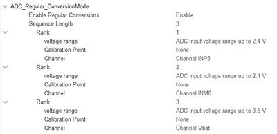

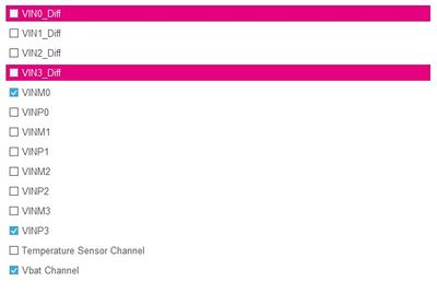

I am using a STM32WB05KZ of a custom PDB, and I can not read a correct value of Vbattery.
I have programed the ACD (+DMA) usgin CubeMX.
I use DMA to read the analog inputs:

According de manual, the formula for ADC converted data after calibration is the following: Code = Integer(4096/3.6 * VIN) [clamped at 4095]. The result of conversion from Vbat is 0x271, applying the formula I get 0,549V when the Vbat is 3V.
I also use 2 analog inputs in PB2 and PB5 and nome of them read correctly. In other proyects with stm32l105 and stm32wl55 the DMA works. I sure I am doing something wrong...

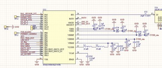

custom PDB
What is the schematic?

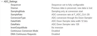

What is the sampling time? Increase it to max.
This is the schematic:

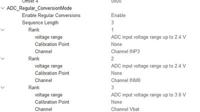

I have changed the sampling time but I get 0x300 (0,675V) as battery level.

I was changed the sample rate from F_ADC_CLK /16 to F_ADC_CLK /28:
- F_ADC_CLK /16 I get 0,549V when the Vbat is 3V
- F_ADC_CLK /28 I get 0,675V when the Vbat is 3V
I don no use any calibration point

I am still getting familiar with the ADCs of the STM32 wireless series, but my practical observations so far are that when using "negative or minus" ADC input ports (I am see in VINM0 above), the measured value starts from 4095 and goes toward 0, i.e to get the "normal" value have to ectract measured from 4095, i.e.
adc_value = 4095 - adc_value;
Again, I am just starting with STM32W MCUs and I may be completely wrong, but it may worth to do few experiments at your setup and to confirm do you need to "inverse", the reading values or not...
