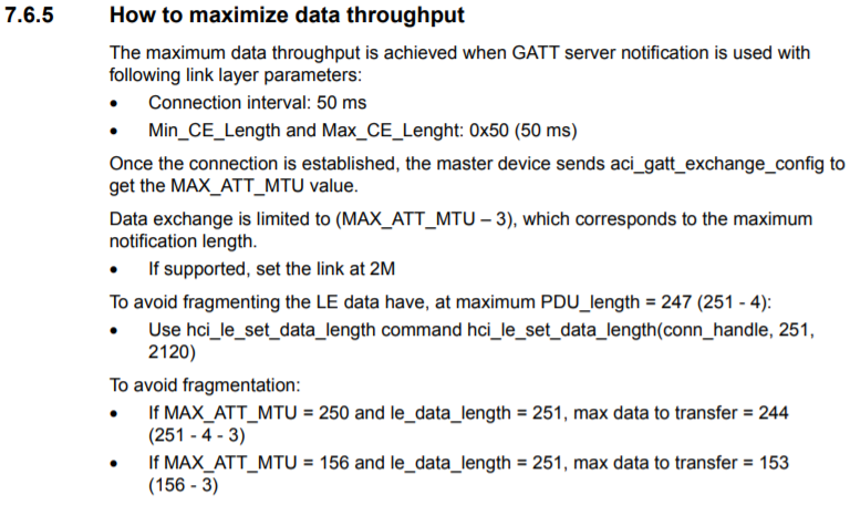

I then altered the code according to ST's AN5289 section 7.6.5 pasted below. I added to the button 2 callback to set the connection interval to 50ms. I changed DATA_NOTIFICATION_MAX_PACKET_SIZE in app_conf.h to 244. I changed hci_le_set_data_length to be (conn_handle, 251, 2120) in app_ble.c. CFG_BLE_MAX_ATT_MTU is already 250 in app_conf.h and changes upon connection.

The max throughput is achieved when the connection interval is set to 400ms. The value mentioned in the application note (50ms) is not the right value.

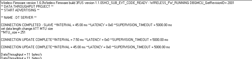

@Eason WANG​ I'm also using STM32WBCube V1.13.3 on the nucleo board and LightBlue app on the phone. I get these results when writting Hello World to the charasteristic. I find them odd campared to yours.0693W00000aJJQPQA4.png
