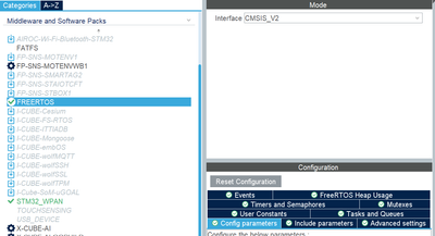

For the First question, on a BLE app, you can enable FREERTOS on the middleware throw CuebMX:
But you can't use FREERTOS together with the Sequencer utility.
