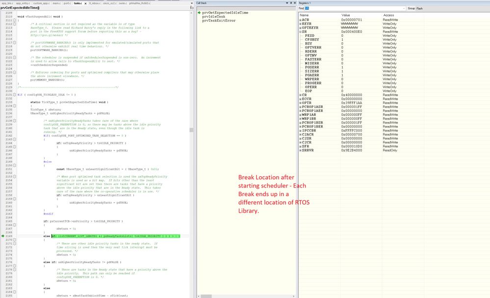

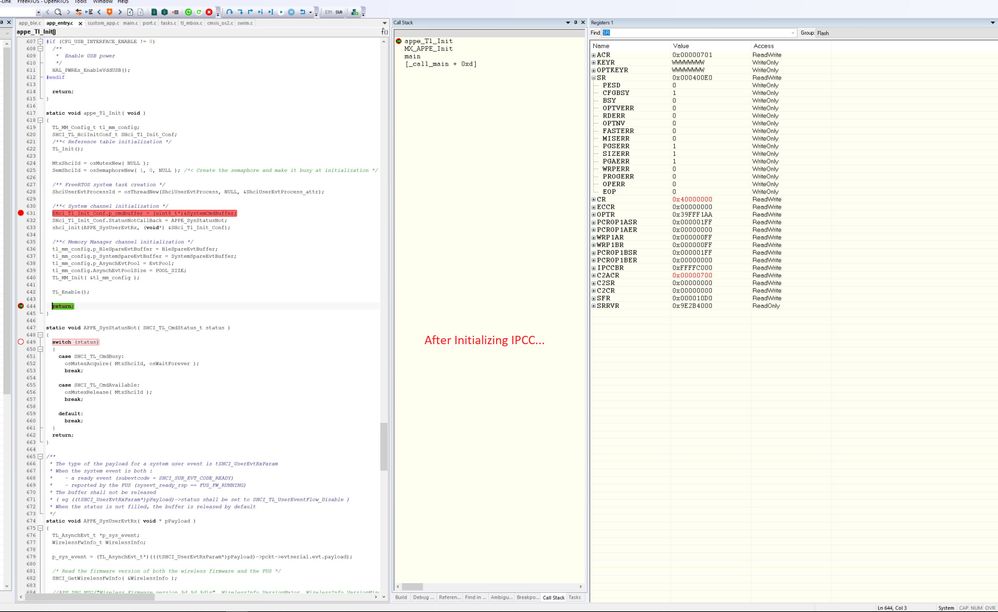

First, with which stack version your screenshots with memory were taken ?
With your screenshot, we can see that CPU2 is in hardfault when SHCI_SUB_EVT_CODE_READY is NOT received. In this case (e.g. breakpoint doesn't get hit), could you click on "Break" button of the debugger and take a screenshot of call stack please and check flash SR register ?
Did you use TIM1, TIM16 or TIM17 ?
When you turn optimizations to LOW, the issue disappears or not ?

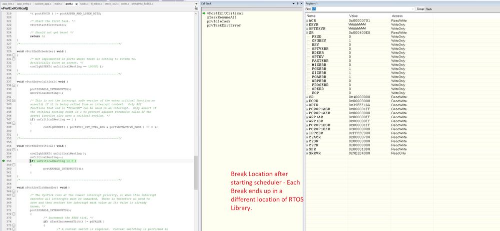

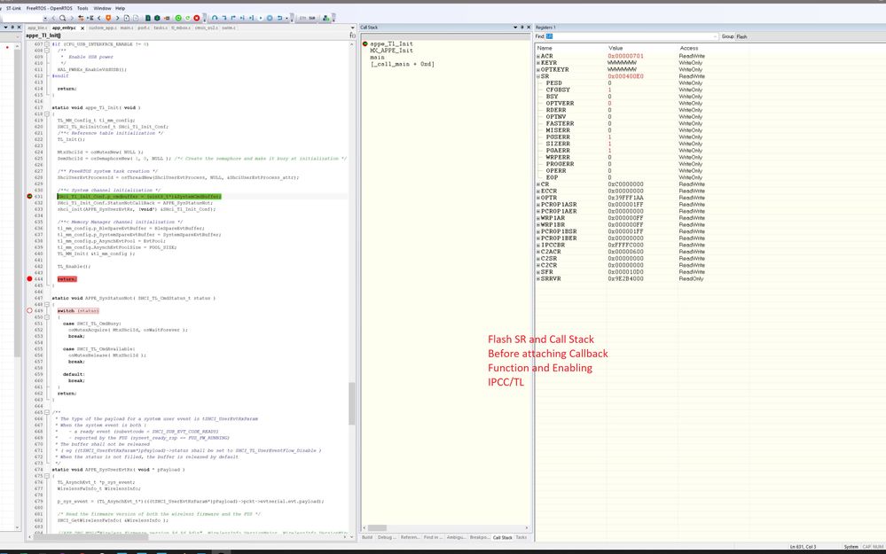

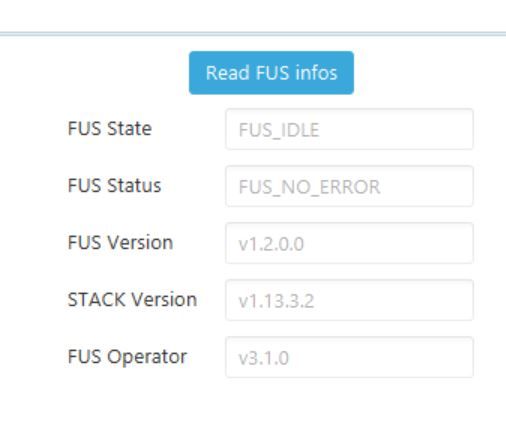

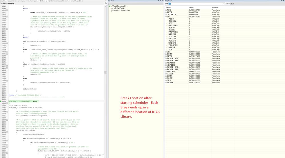

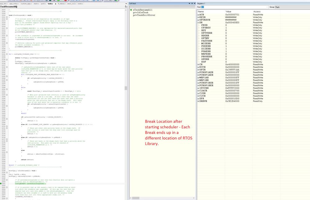

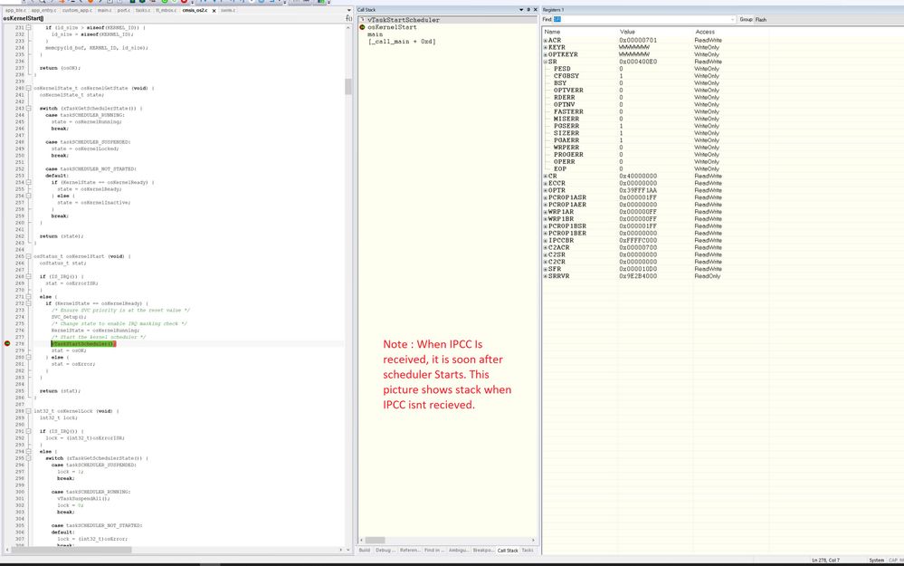

Amogh
  • We have 1.13.3 as our BLE Stack.
  • Can you please elaborate, on how did you deduce CPU2 experienced hardfault? Please see attached pictures that show CPU is somewhere in RTOS Scheduler - (waiting for something..?)
Screenshots shows the Flash Status Bytes before callback is attached, and after IPCC is initialized =>
Screenshots shows where the CPU is Spending its time When IPCC is Expected..

Remy ISSALYS
Thanks for your answer.

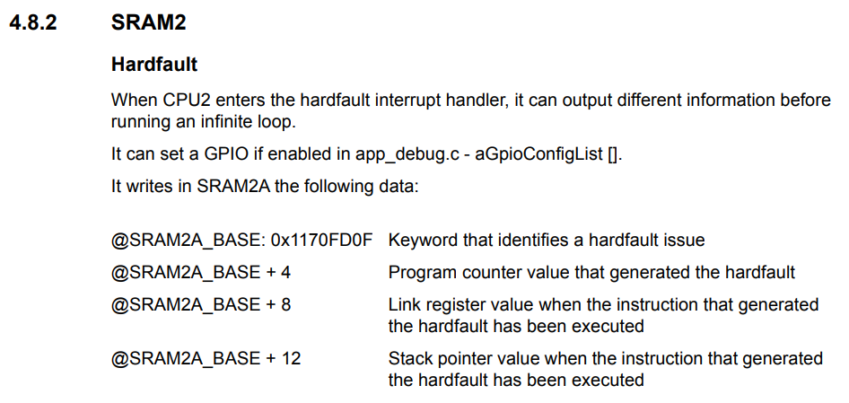

At the address 0x20030000, you have the hardfault keyword according to AN5289:
0693W00000Lxp6HQAR.pngAnd with flash register, we can see that flash is in error maybe causes by writing data at address 0x00000000 of the flash (e.g null pointer).

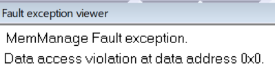

To find the root cause of your issue, you can use MPU by adding the following code:
In main.c :
static void MPU_AccessPermConfig(void);
* @brief This function configures the access right using Cortex-M4 MPU regions.
* @param None
* @retval None
  MPU_Region_InitTypeDef MPU_InitStruct;
  /* Disable MPU */
  HAL_MPU_Disable();
  MPU_InitStruct.Enable = MPU_REGION_ENABLE;
  MPU_InitStruct.BaseAddress = 0;
  MPU_InitStruct.Size = MPU_REGION_SIZE_1MB;
  MPU_InitStruct.AccessPermission = MPU_REGION_PRIV_RO;
  MPU_InitStruct.IsBufferable = MPU_ACCESS_NOT_BUFFERABLE;
  MPU_InitStruct.IsCacheable = MPU_ACCESS_NOT_CACHEABLE;
  MPU_InitStruct.IsShareable = MPU_ACCESS_NOT_SHAREABLE;
  MPU_InitStruct.Number = MPU_REGION_NUMBER0;
  MPU_InitStruct.TypeExtField = MPU_TEX_LEVEL0;
  MPU_InitStruct.SubRegionDisable = 0x00;
  MPU_InitStruct.DisableExec = MPU_INSTRUCTION_ACCESS_ENABLE;
  HAL_MPU_ConfigRegion(&MPU_InitStruct);
  /* Enable MPU (any access not covered by any enabled region will cause a fault) */
  HAL_MPU_Enable(MPU_PRIVILEGED_DEFAULT);
  return;
Call this function after SystemClock_Config like this:
SystemClock_Config();
MPU_AccessPermConfig();
Add a breakpoint in MemManage_Handler function.
Run your project with debugger and check if fault exception occurs and look call stack when the fault occurs to see cause of this fault.

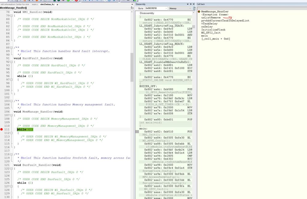

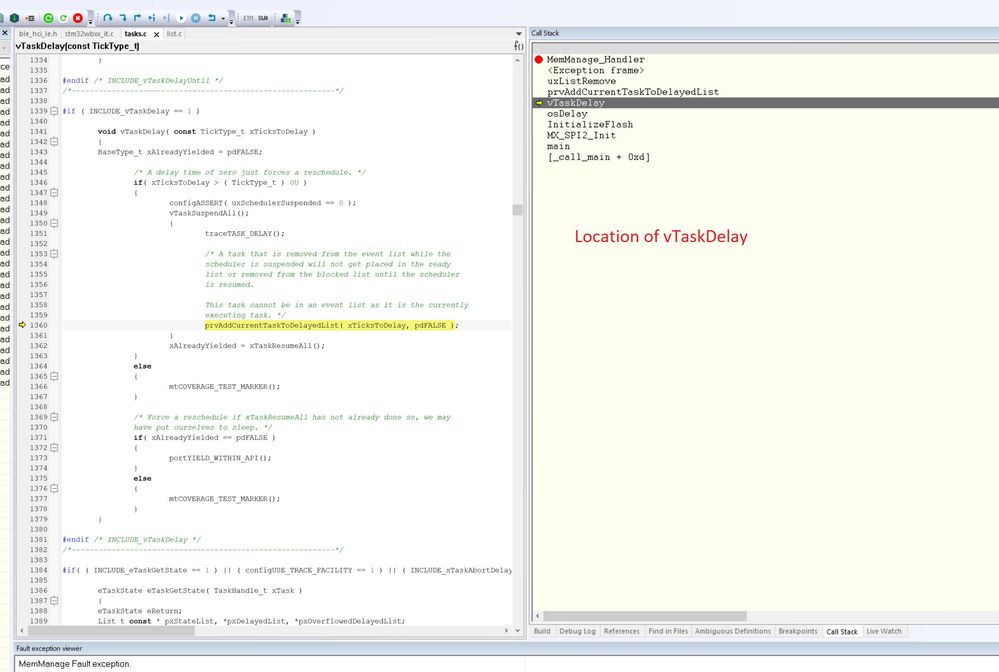

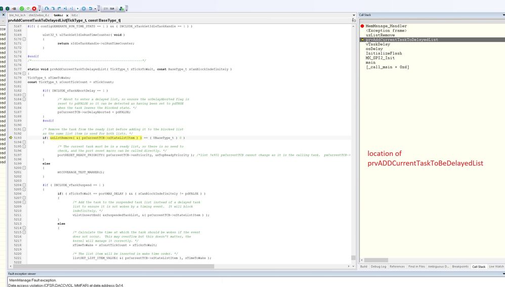

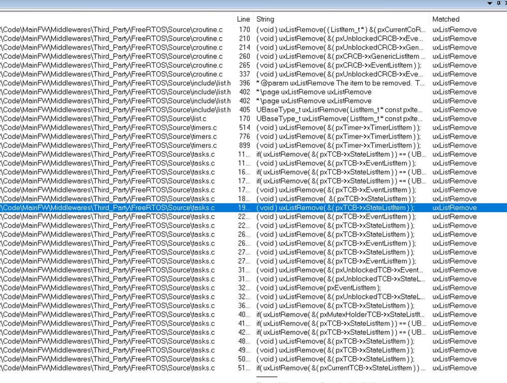

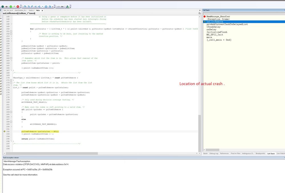

Amogh
Thanks for such a detailed response.
I followed your advise and attached below are the screenshots for
  1. Stack at Hardfault Failure
  2. Locations where the function causing failure is present.
  3. Instruction(@PC) which is causing the failure
I am assuming since uxListRemove() is the last function on the stack, and since NULL node is being removed, a crash happens. Would I be correct?
I am still looking into the exact location in the file where this function is called.
0693W00000Lxub5QAB.jpgThanks
