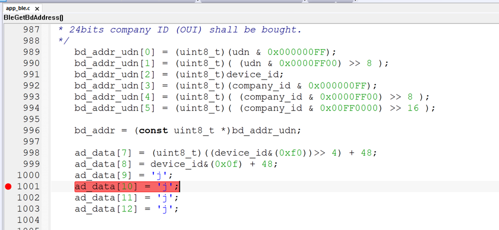

BLE Stack works fine, but when I make small changes, ie uncomment line 1002, and 1003, I DO NOT get a SHCI_SUB_EVT_CODE_READY event.
0693W00000LwroYQAR.pngWe are using RTOS, with BLE co-processor binary version 1.13
Can anyone from ST please provide some insights as to what might be the cause of this behavior?

but when I make changes to the BLE thread - like uncomment
line 1003: ad_data[12] = 'j'
breakpoint/function in step3 is never hit.

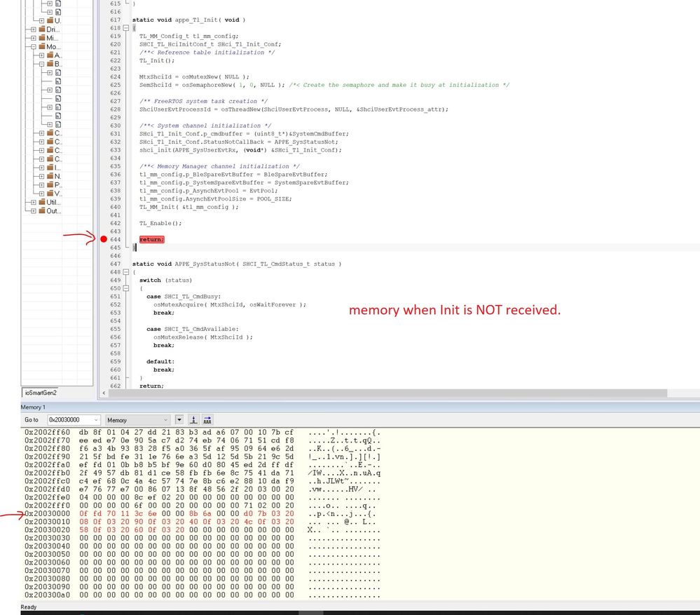

When SHCI_SUB_EVT_CODE_READY event is not received, can you stop your debugger, take a screenshot of the call stack please and look what the CPU is doing ?
Can you also take a screenshot of the memory content at 0x20030000 (first 4 word of 32 bits) ?
Can you add a breakpoint in shci_notify_asynch_evt function and check if you see the event or not ?

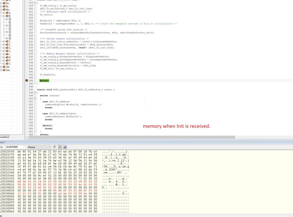

0693W00000LxHBmQAN.jpg0693W00000LxHBrQAN.jpgHi,
  • I am not sure how to pinpoint the state when SHCI_SUB_EVT_CODE_READY is NOT received. Can you please explain which function should I set the breakpoint on?
  • I added a breakpoint shci_notify_asynch_evt but this breakpoint does NOT get hit.
  • I noticed, when init command is received, it is right after scheduler is started with osKernelStart() function in main.c
  • This last image shows the callstack, when I remove the change, and rebuild and reflash, and init command is received.
Thanks
