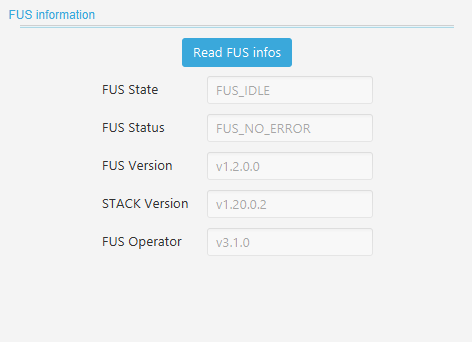

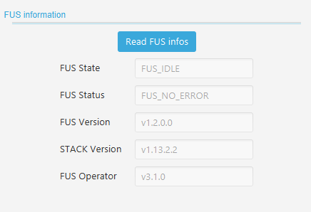

P-NUCLEO-WB55
STM32WB5MM-DK
STTwo-32
January 15, 2025
Hello @Leimen1007
Could you please try to update the Stack using the .bin files available on the last version of the STM32CubeWB V1.21.0.
Best Regards.
STTwo-32
