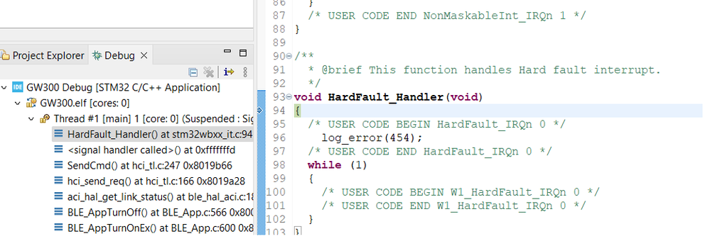

I am working on BLE with STM32W55RGV. I have loaded FUS+Full_BLE_stack into the M0+ core. In the M4 core, I have my own application, but I always get a HardFault when I call this function, as shown in the picture (SendCmd(uint16_t opcode, uint8_t plen, void *param)). It is basically first entry function to try to do anything with BLE. At that moment, opcode = 64535 and plen = 0. Could this be related to IPCC? I have enabled interrupts for both RX and TX, and I have also increased the BLE FreeRTOS stack to 1024.

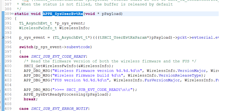

Alos I added breakpoint to APPE_SysUserEvtRx - to see if CPU2 is ready (was mentioned in  STM video tutorial for HeartRate monitor), but the function is not called..hf2.png

Do not how is it related to it, but this is solution:
void TIM1_TRG_COM_TIM17_IRQHandler(void)
  /* USER CODE BEGIN TIM1_TRG_COM_TIM17_IRQn 0 */
#if 0
  /* USER CODE END TIM1_TRG_COM_TIM17_IRQn 0 */
  HAL_TIM_IRQHandler(&htim1);
  HAL_TIM_IRQHandler(&htim17);
  /* USER CODE BEGIN TIM1_TRG_COM_TIM17_IRQn 1 */
#endif // Endof comment out
  if(htim1.Instance != NULL)
  if(htim17.Instance != NULL)
  /* USER CODE END TIM1_TRG_COM_TIM17_IRQn 1 */
