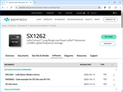

Semtech provide hardware-independent software on their Product Page:
https://www.semtech.com/products/wireless-rf/lora-connect/sx1262

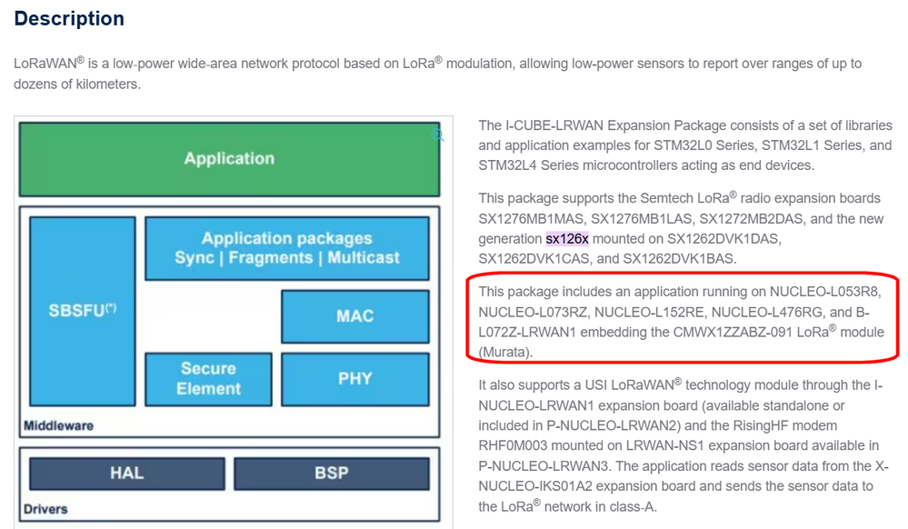

Having said all that, ST's I-CUBE-LRWAN provides specific support for STM32.

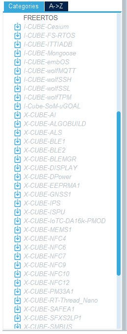

I'm having trouble adding I-CUBE-LRWAN; it doesn't appear in the options:

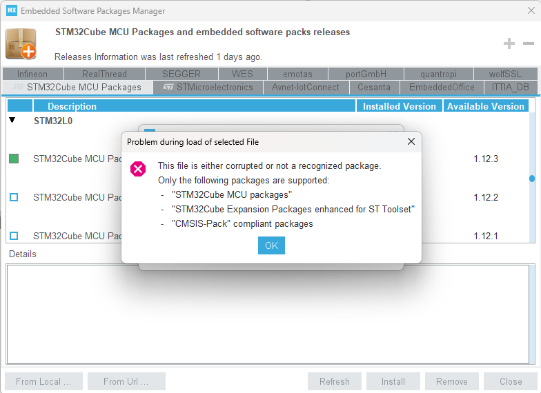

I tried manually adding the .zip file, but got the following error:

It isn't actually a Package like that - it's just a bunch of source files.
You just unzip them.

Does I-CUBE-LRWAN support STM32L031 family microcontrollers?
It doesn't provide a ready-to-go project - but porting from one of those listed shouldn't be hard.
As @Tesla DeLorean says, try building one of them and see if that'll fit ...
